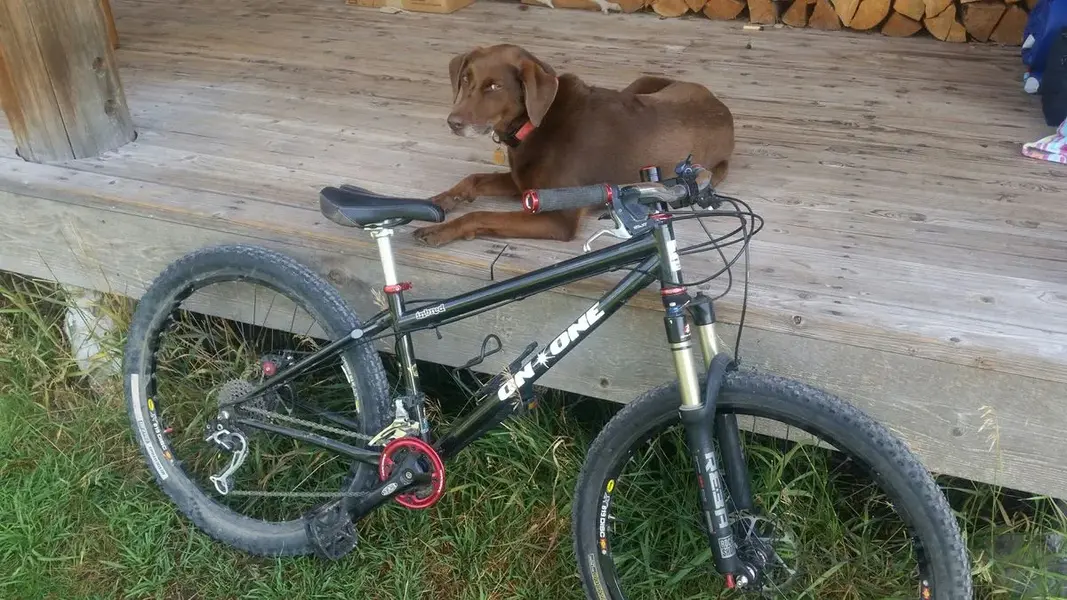

I think you're giving bike snobs a bad rap. I built up a tiny one too, for my 10 year old son last year, using high end 26" components from some of my old bikes. I'm as big of a bike snob as there is, and the Inbred was the only frame I could find, at ANY price, that was worthy of a high quality build, and that I could imagine keeping around for another 5 years or more until he grew out of it:
Gotta keep our demographic descriptors accurate: "Bike snobs" are people who take BIKES too seriously. Those guys who assume that their $5,000, disposable, plastic, weight weeny things are superior, and who therefore look down their nose at a good steel frame, are "consumers" or "marketing department target audiences." They take THEMSELVES too seriously.
All that said, if I lived in the UK and was looking for an inexpensive, steel, single speed that would make me giggle, could do anything, worked well with my 6'-2" frame, and that I'd want to ride for the rest of MY life, I'd forget about suspension get a Stooge. However, if you have really nice 1/8" fork and 26" wheels that you really want to use, the Inbred is a perfect choice
Re-reading the OP's original post, I guess I should clarify that, as good as the inbred is, it's not really designed around a "modern" riding position.
(Assuming that by "modern" you mean: slack seat tube angle, low bottom bracket, short reach and tall stack height to take the weight off of your wrists and put it on your feet; and short stems and shallow front end angles to make downhills more fun and to keep you from doing endos.)
My personal feeling is that although the Inbred works with a 100mm fork, but it will be much more like the traditional XC geometry that you're used to, requiring a longer stem and a more stretched out riding position. Especially if you're on the taller side because, just like with traditional XC bikes, the head tubes and stack heights really don't scale up proportionally with the larger frames.
