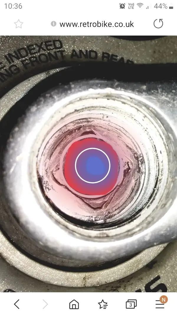

Firstly, make sure your tip fits within the square boundaries. So the tip fits within and pushes back against the crank.
I've dealt with this before, once had to drop a small washer in the void for better contact.

Drop a washer, other flat and hard thing for contact against axle end.
