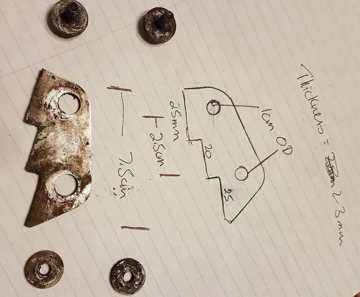

Looking for a used or a good quality photo/image of the Anti-chainsuck plate that came on the DeKerf Team SL from 1998 (or thereabouts)? I imagine souring one will be impossible so will have to look at knocking up my own from an image if anyone has one please?

They are pretty easy to make, just a hacksaw, drill, ruler and time to do it. If you can wait, I can take mine off my bike, trace and send you a pic in the new year.

That is from a dekerf, the frame colour gives it away. I also just realized I posted the picture, so it is definitely from a dekerf.
Okay cool thanks, I'm gonna get the cardboard out and make some little templates and have a play about. Should be a doddle. Question is do I use thin gauge stainless around 2mm or thinker alloy at around 5mm...
If you facy making a few up, i would be a happy taker for one... or if you can make a precise drawing I have a machinist that may be able to make them for us.
I am away for a week or so, when I get back, I will trace and post a pdf with measurements.

Back from vacation.
Here is a tracing and a picture, along with a few measurements from mine.
