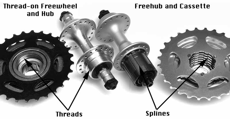

whats the difference between cassette/freewheel
been on sjs to order chain and some other bits
not sure which i need
thanx again slim
thanx again slim
slim,
they say a picture tells a 1000 words
Loads more info here > http://www.sheldonbrown.com/free-k7.html
Unless you've something real old you probably need a cassette.
