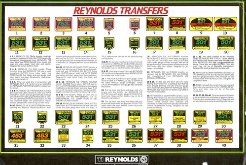

Without seeing the original product managers final spec sheet that the factory used to build the bike frame it's darn near impossible to know what the stays are on a frame. Many companies played the "seat tube" game. Spec'ing only a seat tube to get a name like Tange, Reynolds or True Temper on the frame and make it look better than the whole bike really was.
Someone on here will know more than I do, but I think that the badge probably need to stipulate that the Stays are Reynolds or whatever.
The two pictures here are poor quality, but the red frame definitely only has a 501 main triangle, with generic Stays.

Think I'm just going to have to start asking for pictures of the Reynolds stickers. This could take a long time :(
And what the hell is Raleigh ATT 27? A lot of 90's Raleighs seem to be made of it. I'm guessing ATT means All Terrain Tubing?
Try this for a decent explanation of most recent decals:
http://www.equusbicycle.com/bike/reynolds/reynolds.htm
