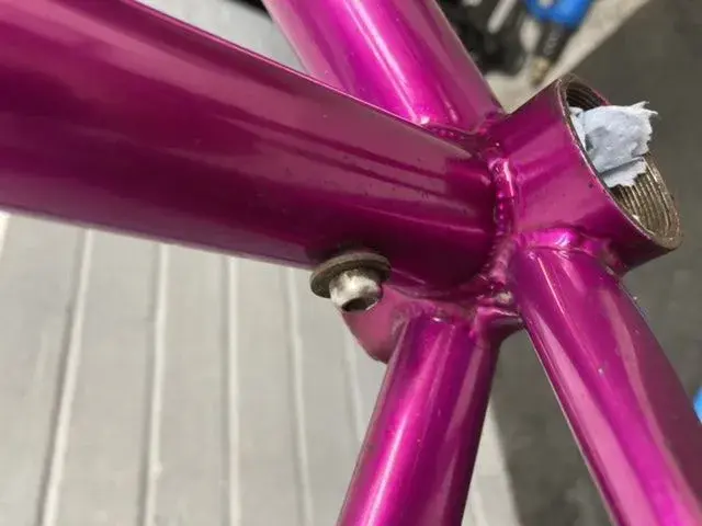

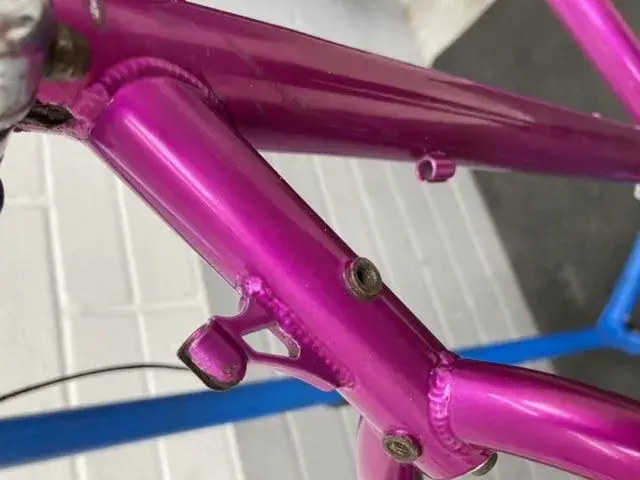

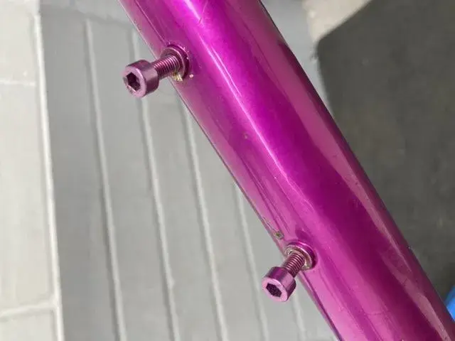

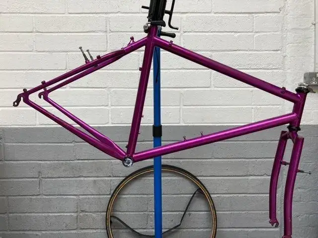

I’ve just gotten my hands on this Orange, thought after scouring many forum threads still unsure what model it is.
I’m thinking a P7 from what I’ve read, but any professional advice would be great, as I’m sure you guys can identify it straight away. Also - is this a factory paint job or no? I can see a faint outline of a down tube decal, but could have just been over this finish at a later date.
Thanks!

Pop the frame nuber up and any other details (diamond bottle bosses, any none normal bosses, wheel hole boos on the back lower seattube etc.)
But not a prestige, so P7 is a good guess.
Serial will give the date you see. (A408.....)
Thanks. Frame number is A4035842.
Some more photos below too -

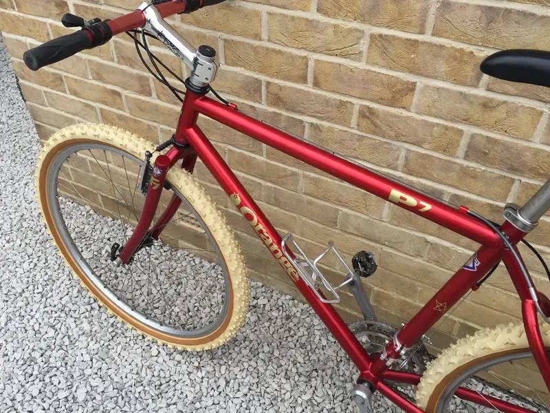

Rare and original colour I think. I have seen a couple in that colour way, but only a couple. I had an equally unusual cherry red P7 which was fabulous - gold decals on metallic red, very high quality final lacquer coat. You could do a totally purple custom build but it would sear your retinas in the sun. Better a silver-purple thing I would think. My P7 was red frame - silver groupset. Didn’t want to let it go but workshop bonkers with bikes. For the purchaser (who is riding it, thank goodness) I retained the original groupset and put on white Michelin Wildgrippers. They looked rather good, I thought.
Yours
Hmmm....yours has a roller brazed-on mount for front mech and a C16-R style back brake stop. Still looks more P7 than anything else.
A - A Pro = manufacturer
4 - 1994
03 - March
I thought I saw the bolt for the roller. hence targeting 1994.
Serial makes it a 1994 model so it's a P7, one of the earliest too.
Anyone else have other ideas?
