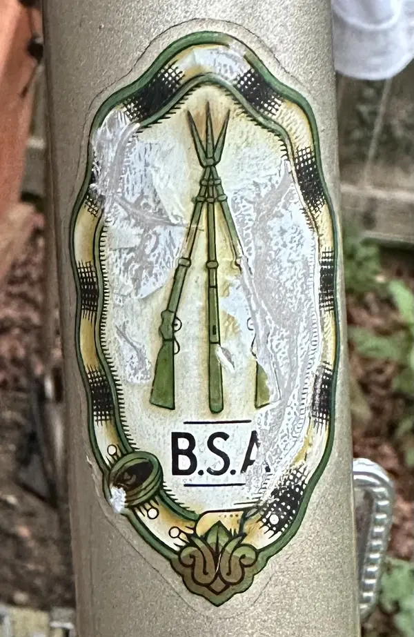

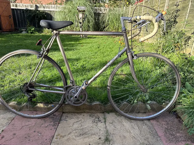

Hi All, Ihm new to the site, I’ve just retired and have acquired my first project. Can anyone help identify my bike. What I know so far is it’s a BSA from 1986 it has gold Mallard hubs dated 1984. It’s clearly a Raleigh frame from what I’ve seen but the head tube badge is puzzling me, I’ve seen 1 other of the same colours on what looks like the same bike. Can anyone help? IMG_1702.webp

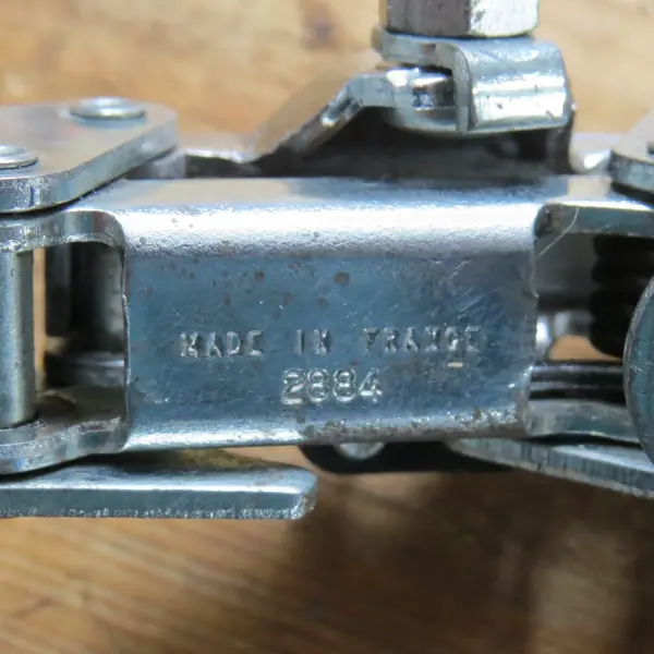

wrt dating -
the machine's three Sachs-Huret components are marked with a date notation of four numerals
the first two numerals indicate the week of the year and the second two indicate the year as in this example -

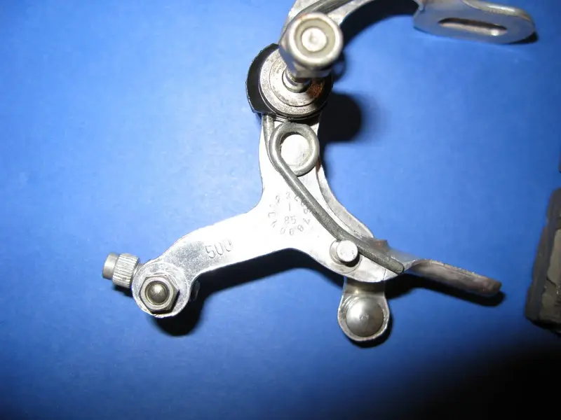

the backside of the brake caliper arms should be marked with a clockface type date symbol as shown here -
You are absolutely right about the Raleigh roots. BSA were a Raleigh brand by then, probably one of their later bikes. Maybe a tour de france?
the seat stay treatment when combined with the ESGE Pletscher plate style bridges is suggestive of a Puch/Steyr origin, Graz, Austria
one simple check which would be consistent with such an origin would be steerer diameter: if 26.0mm that would be confirmatory, if 25.4mm it would leave it open
