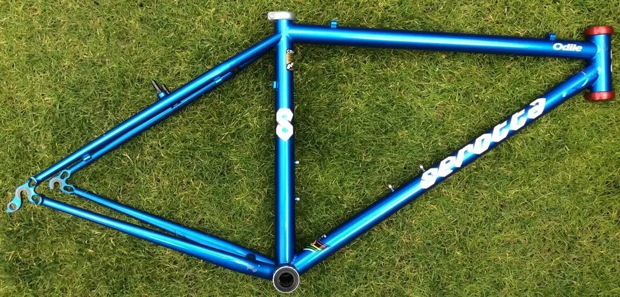

Wondered if someone could help advise. Recently bought an old Serotta 'Odile' MTB frame for the wife. We’re long time roadies (although I used to ride off road a fair bit when I was younger). Instead of buying into the whole 700c/650b ’gravel’ thing plan to build up a couple of 26” hard tails.
So, I’m looking for a fork for said Serotta. The Manitou ‘Mars C’ and 'SID World Cup' was a go to when I was riding however not sure finding a SID WC with a 1 1/8th steerer is realistic.
Any suggestions for a lightweight fork I could build this frame up with? Not worried about period correctness as more interested getting something that works with the frame geometry and adds to actual handling characteristics.
You’ll have to forgive my ignorance and I’m only guessing here, but I’m assuming it would be a fork with less than 100mm travel? I probably need to email someone on the Paceline Forum as might have info re frame geometries etc.
As said any input would be appreciated.
Thanks in advance.

Thats a nice looking frame. Deserves a decent fork for sure. I'll have a rummage and see what I gave spare. I bought a lot of new parts ages ago for 32mm rock sjox forks and have probably built all the forks ill ever need, tbh some I have are probably surplus but I've a hoarding problem.
Pace RC36 or Marzocchi Bombers are nice forks. Have you thought about rigid, some nice P2's or RC31's would go great on this frame.
With that red head set ... I will go for a Withe brothers SC 80mm ... if the geometry allows that. They looks quite nice.
images
I like Serotta with White Bros fork 8)
