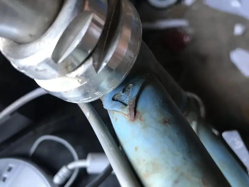

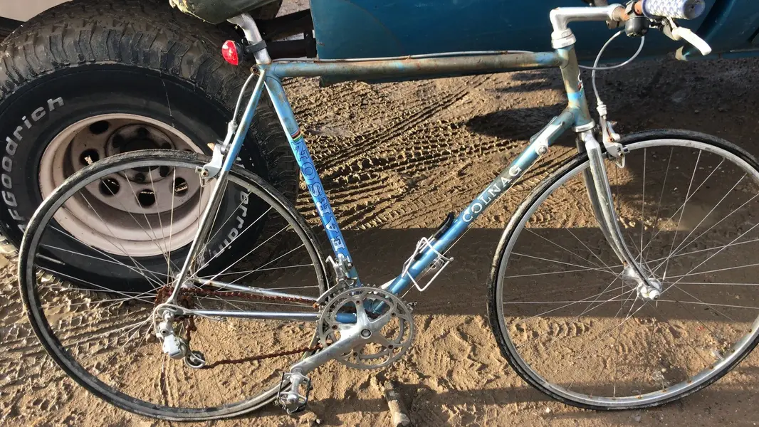

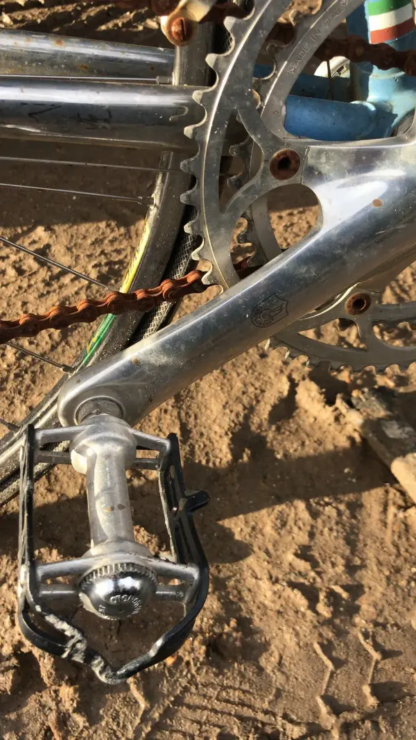

Found this in the scrap metal over the weekend. Stickers say Colnago but the heart shape on the lugs doesn't seem to match anything online. Looks like the remains of a Columbus Aelle sticker, all campagnolo components so I don't think it's rubbish. Any ideas?

Well to me it looks like a colnago but you’ll need an expert to help you out with that.
Even if it isn’t a colnago you’ve got a pretty healthy looking complete campagnolo Athena groupset there.
Doesn't look like a colnago as there would be clover leaf cut outs and colnago pantographing on the seatstays and fork crown
The heart cut outs in the lugs are standard lugs used by lots of builders on better frames
Doubt it's a Colnago, neither the seat lug, top tube cable guides nor the stays at the rear drop out tally with any that I've seen on Colnago frames. The head tube badge appears to be mounted high as well.
Having said that, looks like a decent bike is hiding under the grime and it'll look even better when cleaned - I'd not complain if somebody left it in my driveway.
That doesn't look like a Colnago. All the details are wrong as above^^^
