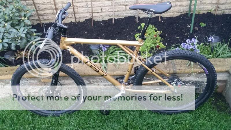

Hey. Newbie first post, and I wonder if anyone could help me identify my frame. Originally I thought Zaskar but a few things on the frame are bugging me, so now I'm unsure if its an avalanche or something else. Take a look and let me know what you think.

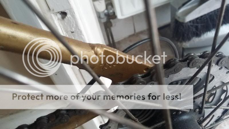

It's the rounded end to the top tube that's bugging me most. Whats your opinions? Thanks.
Tell him why...
(Curved end plate on the top tube means not a Zaskar)
So would you say its most likely a 92-95 Avalanche AL with the extra butting around the top tube/headset area?
Definitely Taiwan made and 93 or later. That's not extra butting around the head tube. Thise are called gussets. Is your rear hanger two bolt or one bolt? Does the serial number start with an H or an S? Followed by what number?

It starts with an SK65. I think if its not an avalanche then my next guess is a backwoods, but if just going on what looks similar from old pictures of bikes and old GT catalogs I can find online.
Another snap with a few new additions
