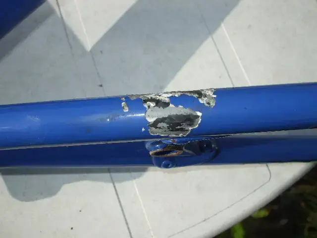

& why do people keep saying it may be aluminum, he keeps saying that its not because you can see through the chips that is carbon fiber, which i can see through some of the nicks displayed in the photo.

that and im a total retard, because the black on those nicks appear to be paint, and you can see the metal surrounding them

What looks like metal on those rear stays is the undercoat/primer.

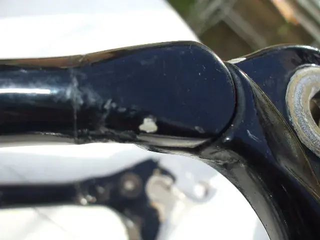

As promised - close ups. the scratch and chips are down to the surface the pic of the rear stay shows undercoat on white and primer in grey with the surface in black. I have tried lightly scratching the surface but can't get it to come up shiny :)
you can see the stays/ dropout link is achived with a bonded lug.
