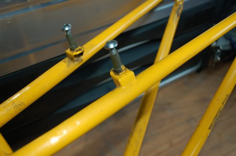

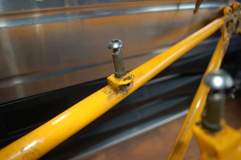

I've measured it in inches and it is as follows (centre to centre)
Seat tube 14.5 (17 to the top)
Down tube 24
Top tube 20.5
The BB is indeed a 68mm and the seat tube is ovalised where it meets the BB and the top tube where it meets the head tube.
It weighs 3.3kg (7lb 3oz)
Here are a couple of pictures of the bosses.
I'm convinced it is the original paint, as even to over spray inside the tubes shows no sign of an alternative colour.
Ultimately, it doesn't matter what it is, but I'm curious now it's caused so much discussion :D
As others have mentioned, those canti bosses don't look original. That coupled with what looks like a very slightly uneven surface where the a set of U-brake bosses would've been suggests a modification at some point.
I had a very similar mod done to a 1992 Bravado frame back in 1993.
Anyway, the frame details such as the internal top tube cable routing, the double eyelets on the dropouts, the integrated seat-clamp and the curved seat post hole, point to a lower end GT from 1991 or 1992.
Higher end 92 bikes would've had the 'groove tube' and no rack mounts etc.
As far as I know, none of the 93 bikes would've had any internal cable routing, and wouldn't have had a U-brake.
So based on the frame details, I reckon it's an either a 91 Timberline or a 92 Timberline or Outpost.
The frame weight also ties in with this too.
As far as a respray is concerned, a frame modification would have also most likely meant a respray at the same time. If the frame was properly stripped then there would be no evidence of overspray from the original colour anywhere inside the tubes.

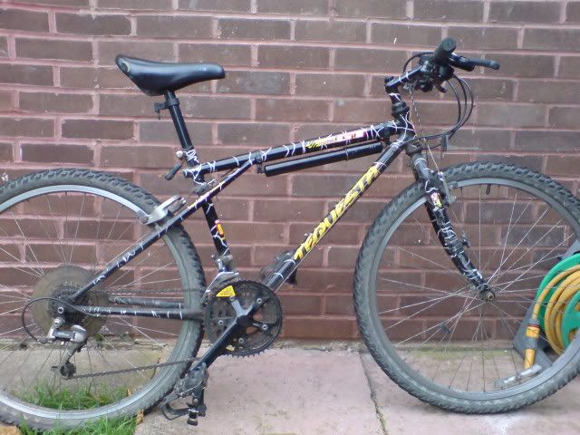

Looking through the archive, and other GT threads I'm pretty sure it is indeed a 1992 frame. Possibly a timberline, but I think I'll decal it a Tequesta so it can match dad's :lol:
Looking at this picture from an old thread the smaller frames don't have bottle mounts on the seat tube.
