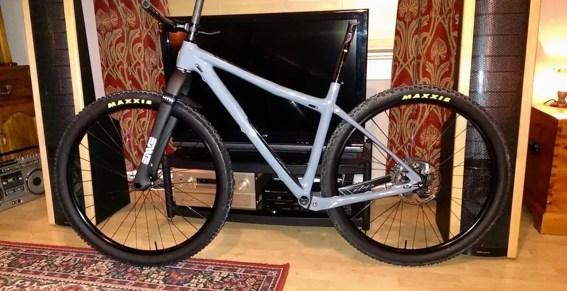

a wee bit of progress since i got home from work at three.....

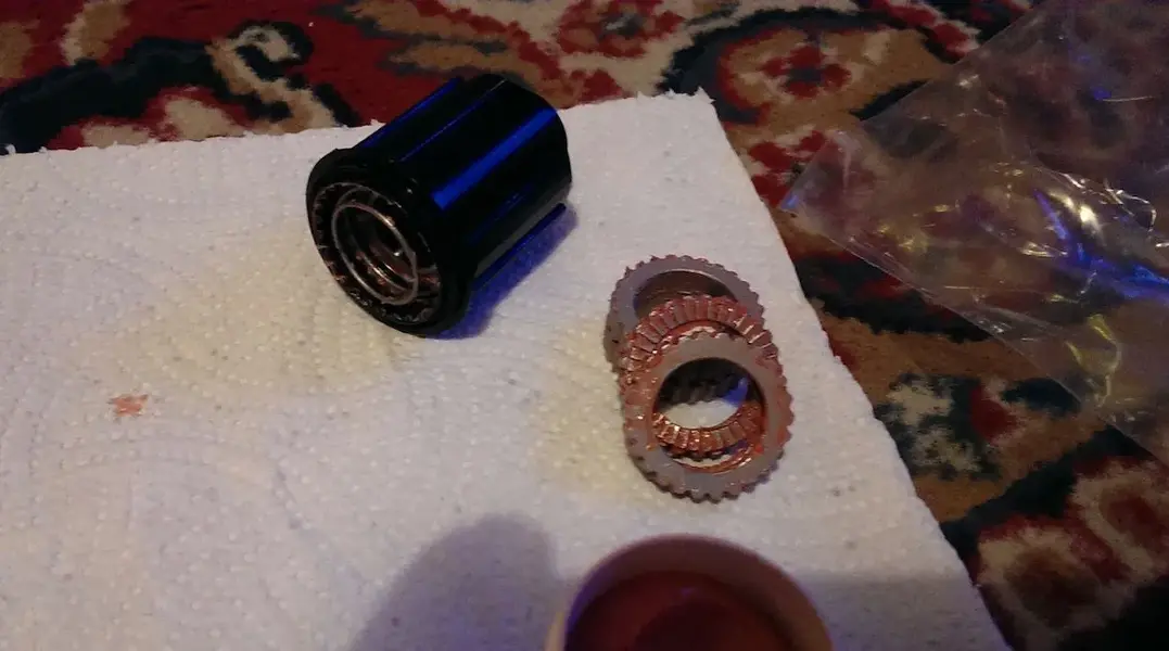

changed out the ratchet drive in the hub. when i bought the wheels i was offered the chance to upgrade the engagement from 20 degrees to 10, with 36 teeth instead of 18, so got that fitted with the pot of grease that arrived today! sounds like angry bees now! :D

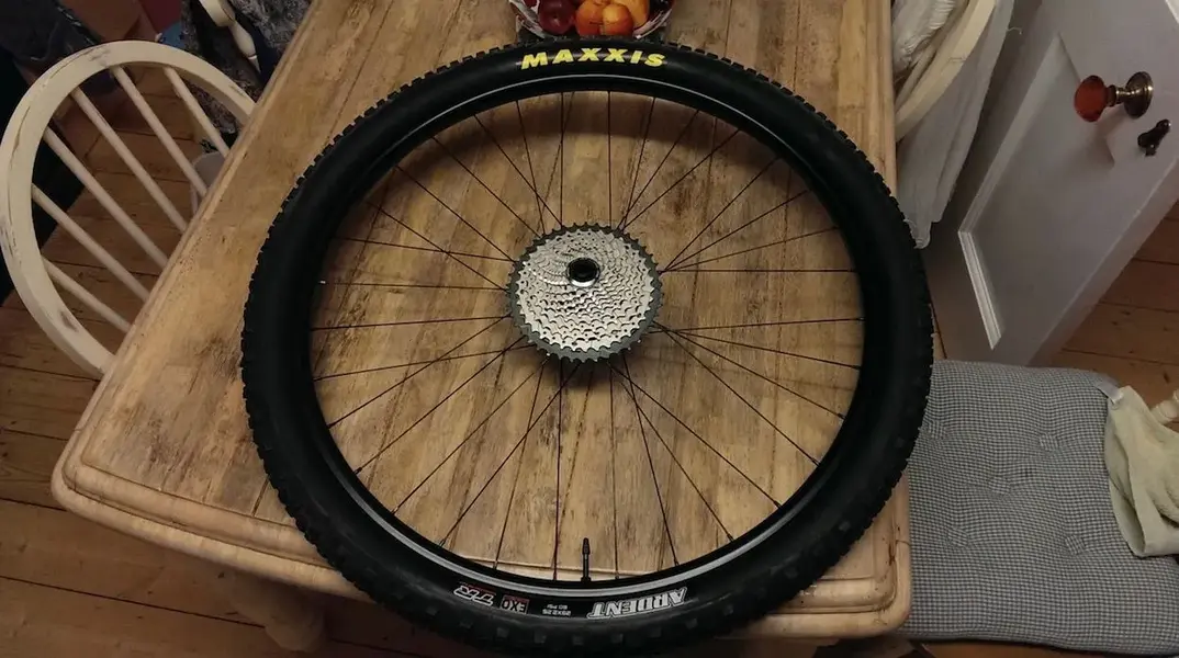

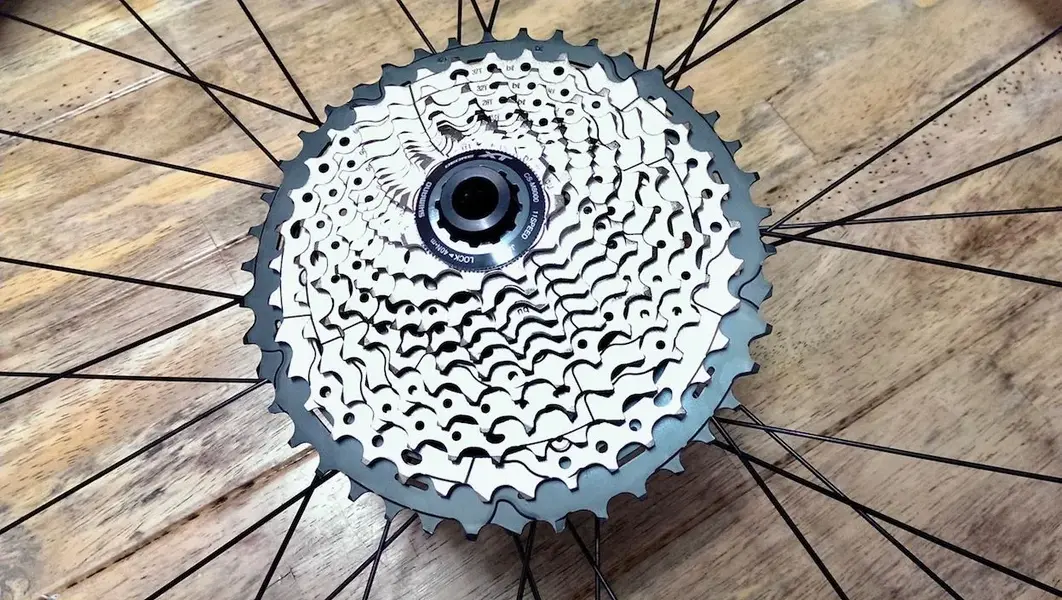

fitted the cassette and the tubeless tyres, and de-stickered the rims. the tyre fitting was a complete doddle! couldn't believe how easy the tyres inflated, straight up with a track pump, both instantly! i've had to use a compressor at a mates garage for some of the 26inch tubeless tyres i've tried to seat in the past! i wound the Stans Rim Tape round twice on each rim, just to help, and soaped the tyre beads, but it was ridiculously easy, and there's no sealant in yet and they're both holding! 8)

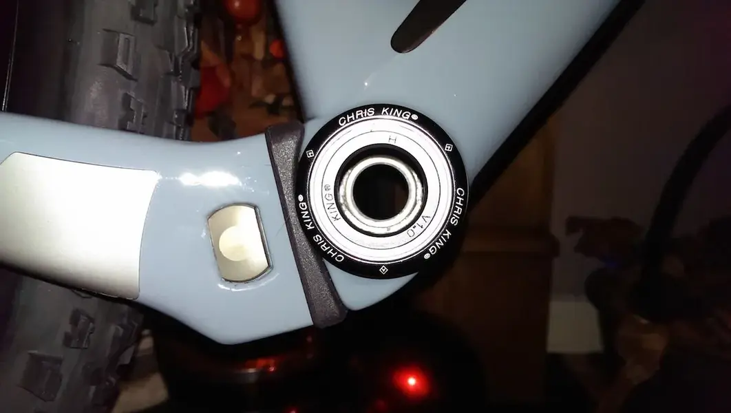

BB pressed in successfully! 8)
edit: horrible thought..... hope i can get the gear outer either above or below the BB sleeve as the outer runs internally?! i guess i could remove the rear end and fish it through..... i hope! :?

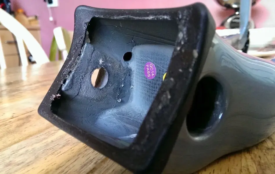

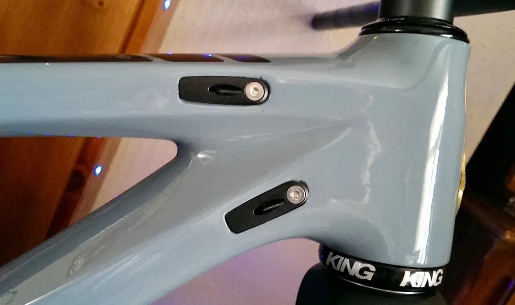

the Tranny has various cable routing options for front and rear mechs as well as a dropper post, but as i'm only using a rear mech and nowt else, i ordered up some blanking plates. think they look smart installed, clean lines 8)

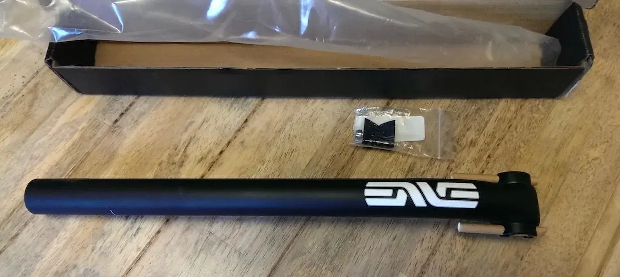

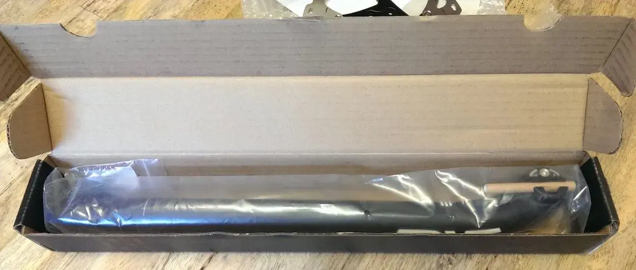

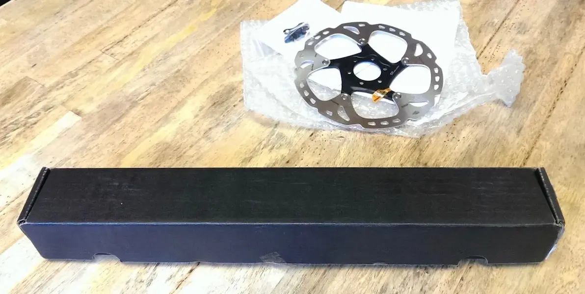

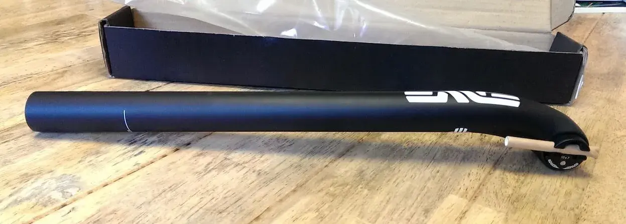

and at last, the seat post and rotor just arrived! :D 8)
