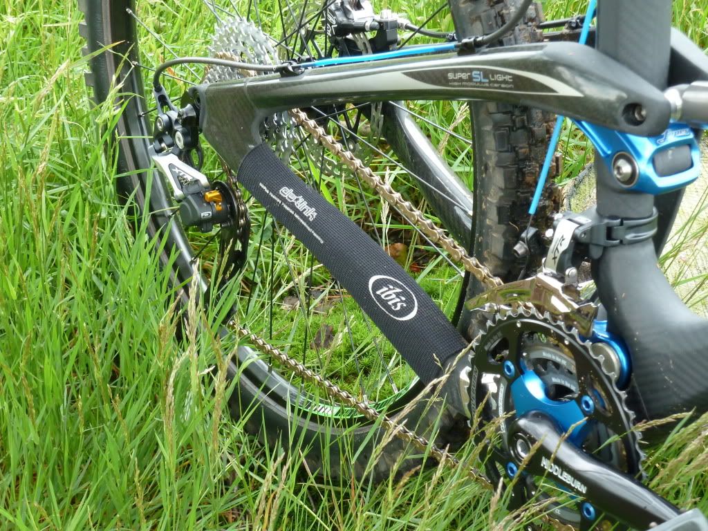

I never really considered the crud catcher tbh. Its just one of those things I've always used on all my bikes. Now its summer and the trails are dry so I guess theres no need for it :oops:

Ive got the Mojo Carbon, they are truely awesome bikes, little slower up than an xc thoroughbred but then who cares they look amazing, pictures never do them justice. Have to agree on the crud comments, but then I don't even like to put my lights on mine.

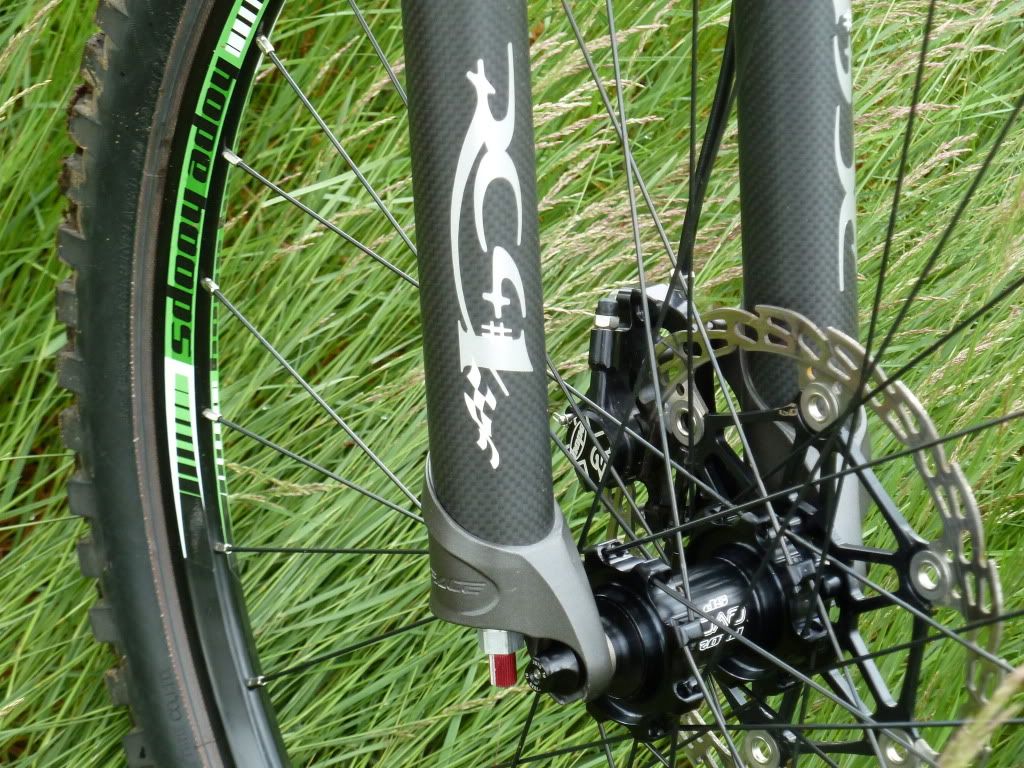

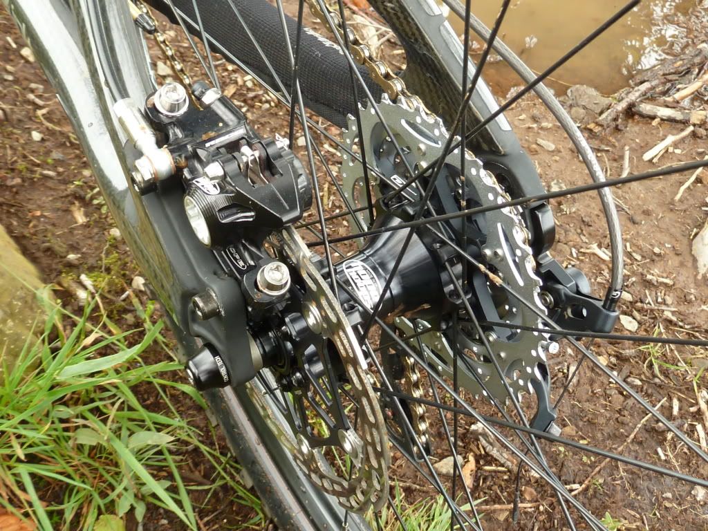

So its been two years since I've posted any updates, but it's still my favourite bike and the spec has evolved a bit since the last pics. The list of changes are as follows:
Shifters and f+r mechs: XTR M980/5 with Goodridge cables
Cassette: XT 10sp 11-36
Chain: KMC X10
Wheels: Hope Hoops Pro2 Evo SP Stans Crest 32h
Brakes: Hope Race X2 183/160
Crank and Rings: Middleburn RS8 X-Type triple
Bars: USE Atom Carbon
Saddle: Charge Knife ti
I've also swapped the 90mm Thomson stem for a 70mm, fitted a new lower link (35% stiffer apparently) and ditched the Joplin seat post for the Thomson that was originally fitted: I rarely used the dropper function and it developed a bit of play after a few rides. I sold it on ebay soon after...
And last month the forks were given a service and new bushings by our resident Pace suspension guru, Tim Justbackdated 8)
There's still a few things on the list: Tubeless tyres, an 11-32 cassette and maybe wider bars but I'm very happy with it as it is :D
Real nice bike. I have never seen one in the flesh :( The blue touch is nice and subtle. Superstar sells brake hoses in different colors as well.
How do you like the rear mech. In Holland averybody is raving about that little 'clutch' system.
