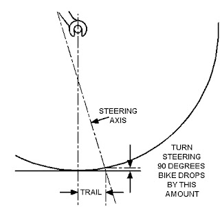

If the forks were straight, ie: zero rake, but still have the same (72ºish) head angle, the fork would have a huge positive trail.
Normal range would be 40-55mm, rather than over 120mm.
This would make the steering very heavy with a lot of wheel flop.
It is possible to have a bike with a straight fork, (see bicycle gymnastics) but these are very special bikes for very controlled conditions and use.
They have the same handling characteristic whichever way around the bars are, but note the steep steering angle to keep the trail within the sensible range:
Have a fiddle with a Trail Calculator, and you'll see that a zero rake fork with the same head angle will roughly double the wheel flop and triple the trail.
