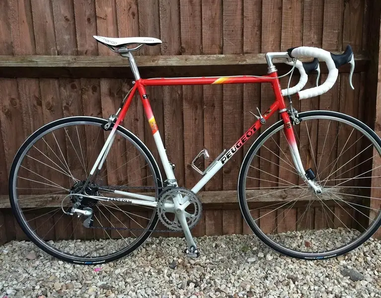

I'm not able to offer insight into the correct way to take on a frame restoration because I'm only just learning about that and the various options/pitfalls myself at the moment - but I did want to encourage you.
I own a Peugeot Aravis from 1988 which has 'the same' frame as yours as far as I can tell - full 531P including forks and stays - and it rides beautifully. Fast and smooth.
So I would say it is definitely worth you preserving that bike and bringing it back to full health - it was not a cheap or low-line frame at all.
Here's mine as it is today - to try and further convince you to do it :)
