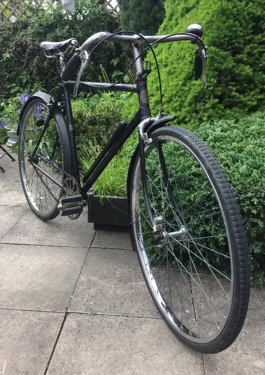

This time it is something I have hankered after for a while. A veteran, proper old, classic bicycle.
It was sitting, unloved :cry: , outside of an antique shop on my way back from University last week, so I had a quick look. It was still there yesterday, in the pouring rain :facepalm: , so we had a chat, I made an offer, and bought it :lol:
I have been able to identify it, but I might need some help with things like advice on the original colour, and whether there is a register or owners group in the UK, dedicated to this marque.
I will start a build thread, though it will be a slow process, as I am still studying and don't have much time or money, and post better pics when it stops raining.
It does seem to be original, and all there. Always a good start.
Allow me to introduce to Retrobike, the 1926 Peugeot "Touriste Dame" (also designed for use by the clergy)

Thanks, I know it's a different world, and it throws up different problems.
Today I found out that the front wheel needs truing. Don't know how this is going to go, as the spokes are soldered at their crossing point.
Also have to rebuild the head bearings. I just hope its only missing some balls. :roll:
Kind of looking forward to the challenges.

I have been having a closer look today Keith. I think I am past trimming the runout as there is significant rim damage. :cry:
Nice detailed Peugeot ID on the rim though. Looks like I am going to need new rims, 26 x 1 3/8, 36 hole.
There is also a problem with the headset, so it looks like I may need a replacement steerer tube, French threaded.....Bugger :facepalm:
Does anyone know of any specialist French restorers or bike dealers in the UK?
