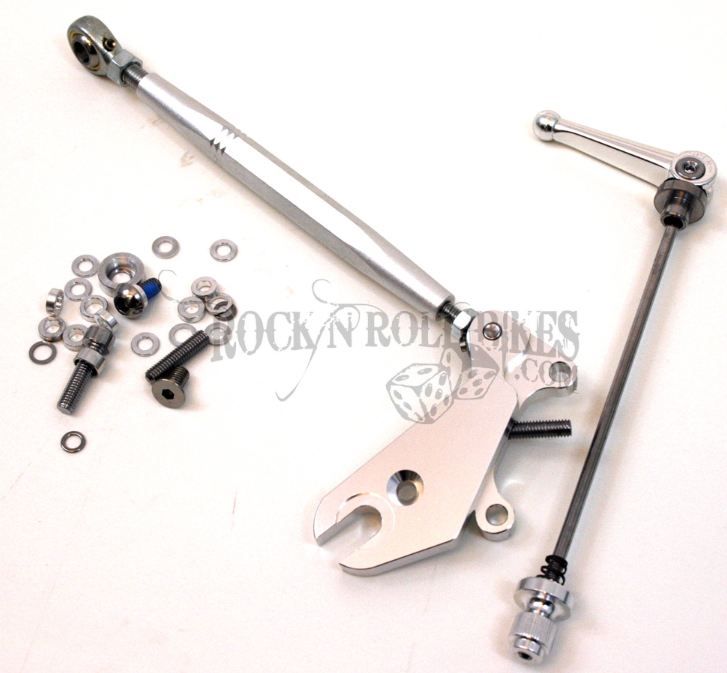

While researching forks a bit, I've realised that most 'decent' forks are for disc brakes only. My frame doesn't have disc mounts, so I might have to use a disc on the front and Vs on the back (which isn't really a problem, except that I already have a full set of Vs and levers, and don't want to get a disc if I don't have to). That said, if I have to get a disc, then do mechanical discs use the same cable pull as V brake levers? A mechanical disc (avid BB7 ?) would be much cheaper than a full hydraulic system, and that way I'd still have a matching pair of brake levers (A non-matching pair would be OK, if the lever shape and size was the same though).
That's why the suggestion was made to look for a second-hand Reba. The 2005-2008 version is nearly the same as the new ones, but came with canti mounts.
That being said, you can indeed run a cable-operated disc at the front.
You could also get an adapter for the frame, which anables you to run a disc at the rear as well.
This is the Onza disk brake adapter, for example. It slots around the axle and uses the left canti mount for the torque arm.
