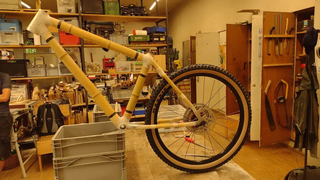

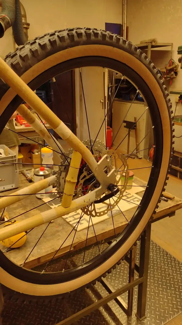

To check whether everything fits on the rear triangle, I tried fitting the rear wheel.
And behold, I somehow messed up the left seat stay.
The tyre didn't have enough room.
Removing the seat stay took more effort than I would have expected at this stage.
But after 30mins of sawing, swearing and hammering it finally came lose.
Then I also tinkered with the bridges for the seat and chain stays and the torque support for the rear brake before reinstalling the chain stay with a slight shift.
Now everything sits as it should.
