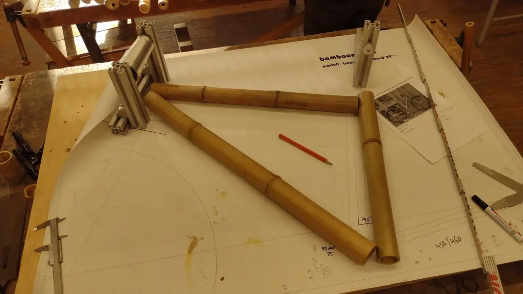

After weeks of mulling over the range of use and geometries, I finally had a sketch ready.
I wanted an MTB, nothing harsh but suitable for fun in the forest and with relatively modern standards to have many options for parts.
So disc brakes and a tapered head tube were set. I didn't use a thru-axle at the rear as the semi-horizontal dropouts were readily available and suitable for a singlespeed without much effort.
Stiffness and performance will be criminally neglected in this project anyway.

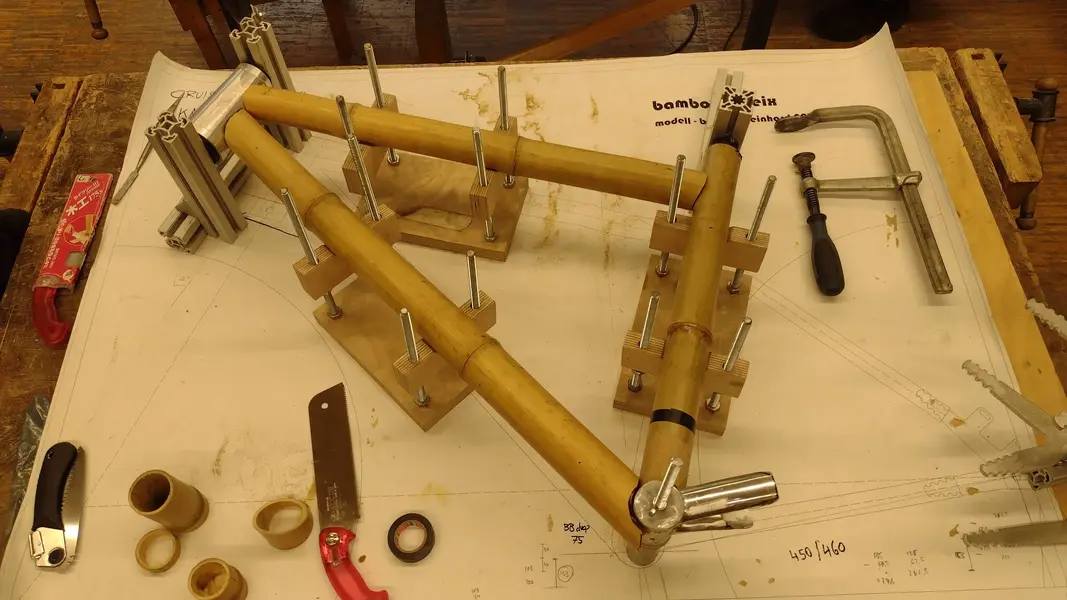

Now the tubes were chosen and had to be cut to size.

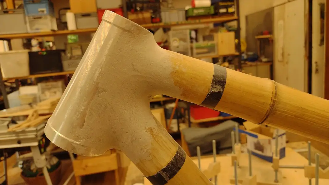

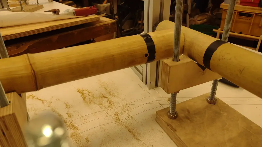

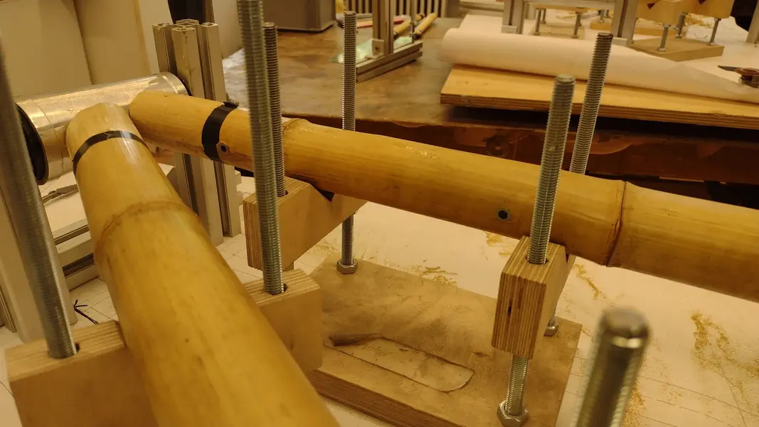

The next step was to carve and file and grind and peel (nothing sticks to the smooth surface of the bamboo canes, which will come in handy... that's why the canes have to be peeled where the resin is supposed to stick later on) until everything fitted together well enough.
The bottom bracket shell and seat tube are recycled parts from an old MTB, the head tube and dropouts are new.

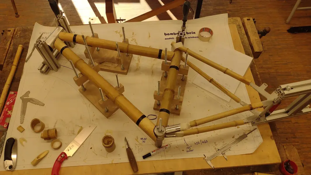

So after the main frame came the rear triangle. A little more carving was required here.

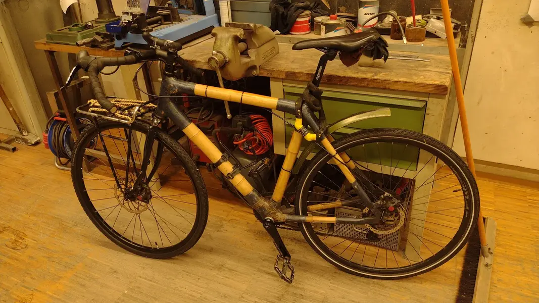

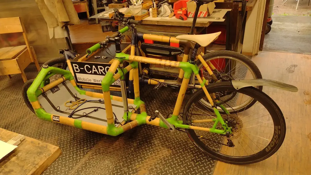

Sadly I didn't take more pics of the seat- and chainstays being carved. But I took a few pics of some bikes that were already built.
Two cargo bikes, one even with ovalised tubes...
...and a daily driver that is in use for some years now.

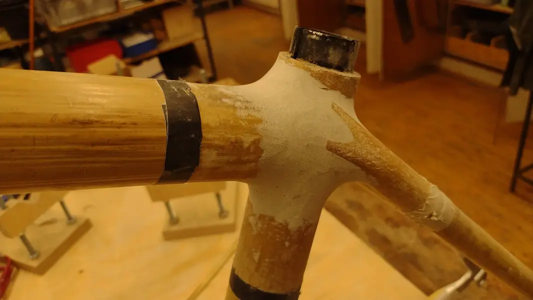

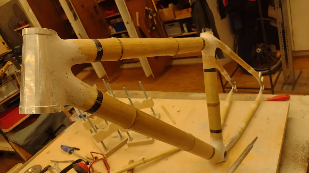

Now the individual tubes could be glued together. Two-component epoxy resin with a kind of cellulose filler was used for this.
Really impressive glue this stuff...
Looks like play doh but it is really strong.

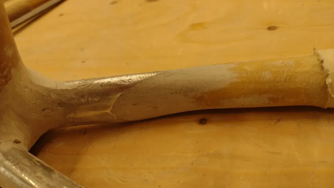

After curing, everything was filed and sanded.
Imperfections were removed in a second pass.
This bonding holds everything together temporarily and serves as a support surface for the fabric so that there are no creases or air pockets later on. At least that's the plan.
Looks like a bike frame to me...
