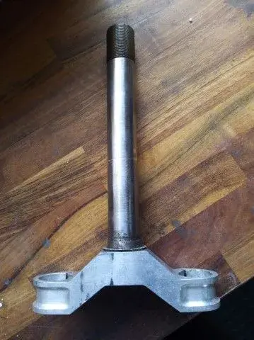

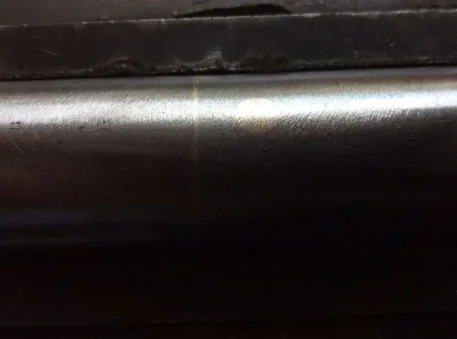

Progress 2:
Internal sleeve brazed in and cleaned up for second stage:
Top section ready to go. Internal loop of filler inside on top of sleeve, two portholes cut to indicate when filler has run:
Filler flowed to joint and portholes filled:
Clean up and finished product:
All the best,

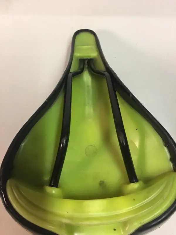

this "Over Restored Poncey Machine" will be sporting this a brightly coloured saddle.. :lol: just needs a darn good clean and polish on the Neon - I think it needs a saddle in keeping with the theme

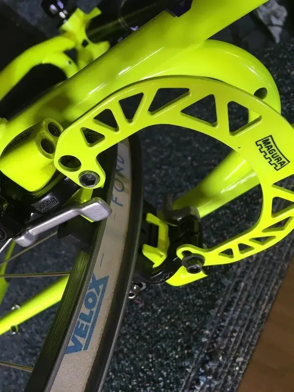

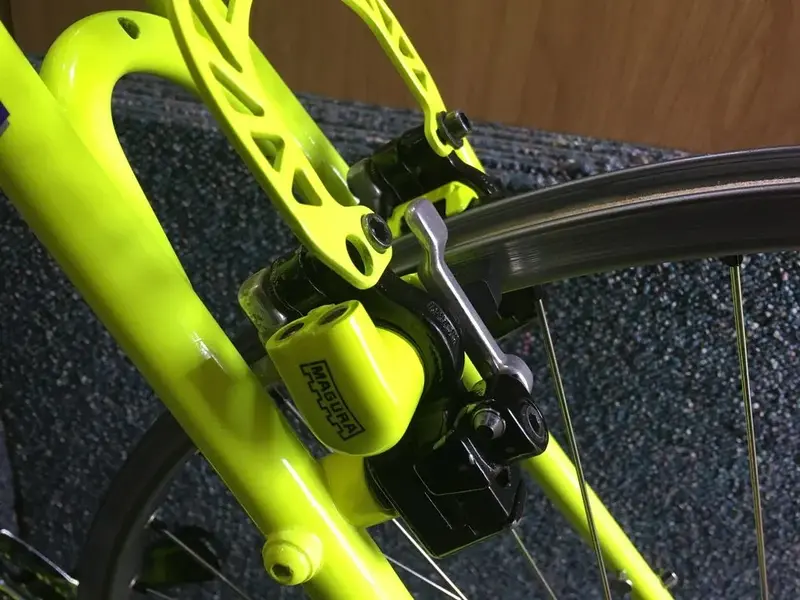

Those decals really make it..looking great. Don't you think the Flouro Magura's will look a bit lost next to the Flouro stays?

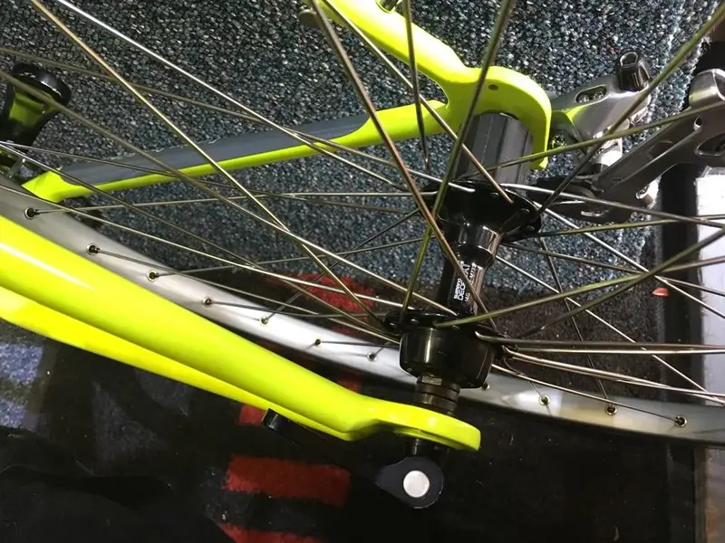

You had me thinking ^ but I've held my nerve and think I chose right, having received the wheels back from being trued up - NOS hubs on 27 year old rims (they have to be the widest rims I've seen in a long while, so wide the Bike shop who supplied the cloth tape joked they had no idea when the last time they old some.. :?
Anyway now they're back I can start to rebuild the thing starting with the brakes
Black and Flouro Yellow 8)
NOS XT M732 and a very lightly used 27 year old rim and Critical Racing Skewers..

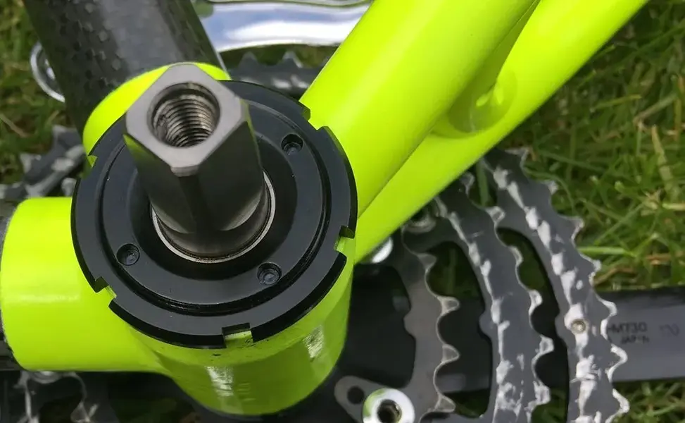

and a Royce 122mm x 73mm axle transplanted into some unknown NOS but rather cool black casings - ready for some equally black XT cranks
