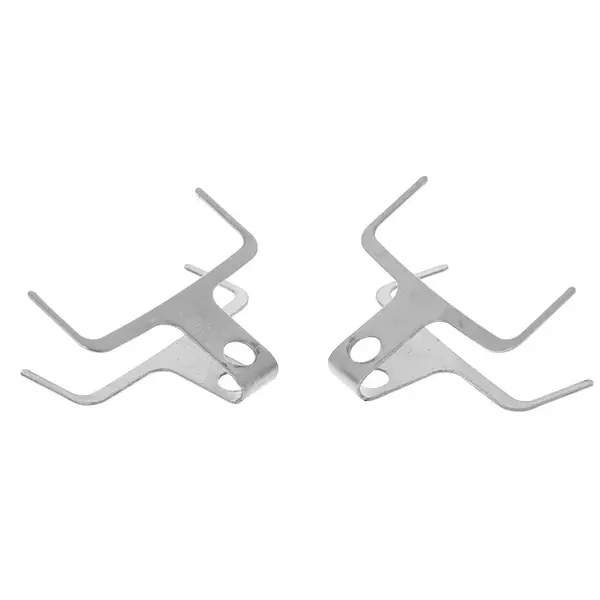

... Deore XT BR-M775 front caliper the trailing edge of the pad is sticking. can this be fixed? I'm new to hydraulic discs.
Has the spring snapped or popped out of place?

Should have a spring similar to this between the pads, sometimes one of the arms snaps or bends, which lets the pad fall inwards.
Also is the pad pin screwed all the way in, it is hard to tell from your pictures but looks like the bolt is not fully in, in which case the pad could be moving.
you were right ;)
this is what i found ....
after comparing with the rear brake caliper it was obvious the clip was not seated correctly..
this is the rear caliper ...the clip is more central...
and after removing the pin and faffing the clip with needle nose pliers...
fiddly but got there eventually ... buzzing :cool:
