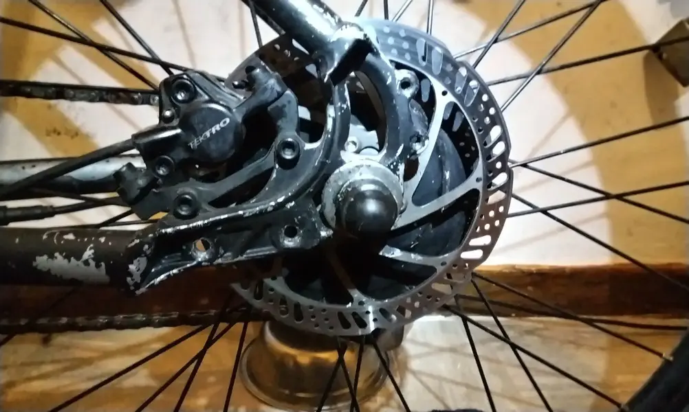

Wishing to upgrade brakes piory the shop installing, currently 160 front & rear rotors & some say can use current others say bigger & including the thicker magura rotors, current rotors have done nearly 2000 miles.
New brakes intended magura trial sport 203mm front 180mm rear as its a hybrid emtb type bike like the focus whisper2 @ 23 kg hub bafang weighty, not wanting the estop version as wish to keep brakes after the bike gives up the ghost for a project plus size ( fathom / stance) mtb.

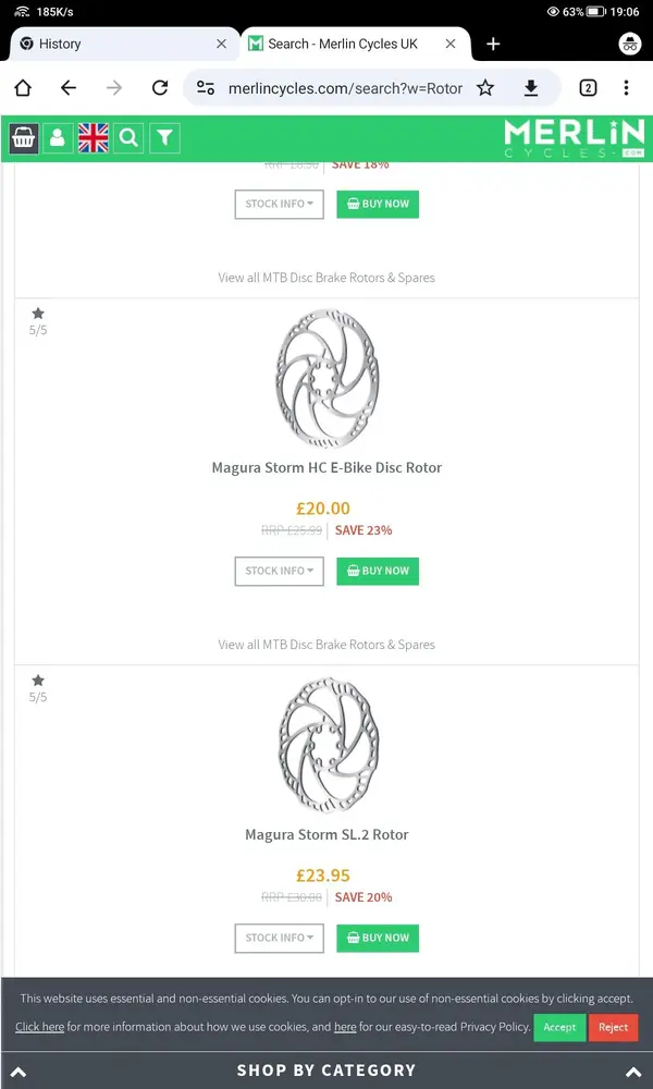

Pictures of current brakes & rotor options as I'm thinking the Magura lite rotors.

Well I've a choice of hc rotors slightly less weight & hdr optimized for ebike vibrations, however the bike is only used on mild trials for short periods, so unsure which to get including the sizes.

Well their post mount, there's an adaptor for 160 to 203 & one that states to increase by 20 mm which I'd assumes could do rear to 180 from 160.

Your front is post mount so a +20mm post mount adapter is needed. Rear you need a 180mm 'Post-mount to I.S' adapter.
