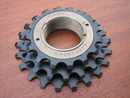

Is the 3 speed 1/8 pitch?

This is the freewheel...

Those cogs look quite thick, does a 3/32 chain fit?

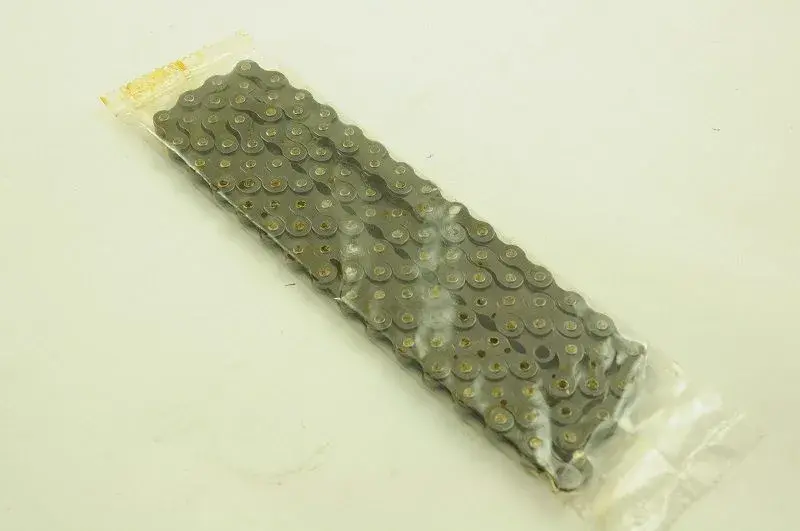

This is the chain, it's a 4/5 speed - i'm hoping it fits!

It would be worth checking your crankset, freewheel and chain are all 3/32". I think the crankset will be 3/32 but the freewheel could be 1/8". Only a guess, its not easy to tell from photos.
