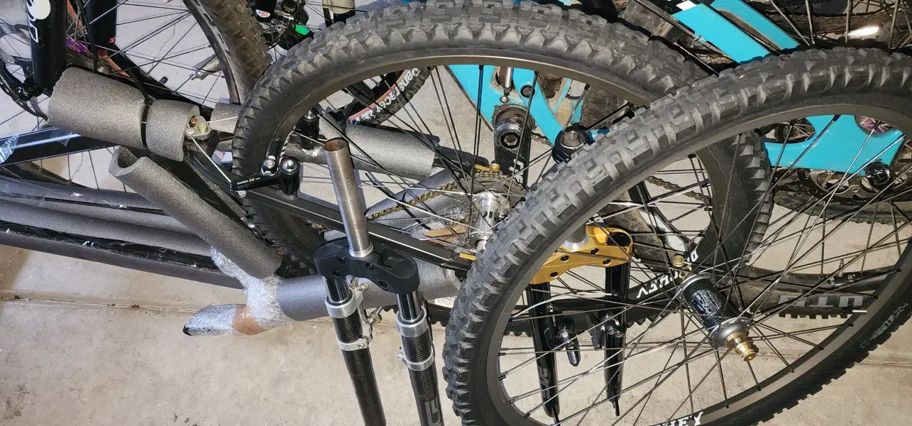

Apologies, awful picture.. the ones on the right ofc. Quite possible 5 mm deviation on both. I will take a better picture when I get into the bike this weekend

Are the legs sitting straight in the crown?
Looks to me that they may be turned in a little which will effect the fitment.
If so, its a simple job to undo them and rotate them outwards a little.
If it's the RC30 with the gold crown? The non drive side dropout and the brake on that side looks like it's pointing inwards. Does it just need the crown bolts loosening and the legs rotated straight in the crown?

That front hub will fit.
Undo the crown bolts,
stick the hub in and rotate the leg till it fits,
clamp the q/r, check again,
align height
Do the bolts back up.
