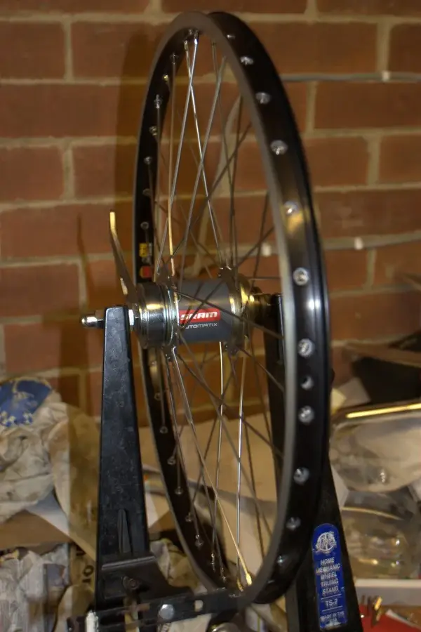

Put the 36 hole hub into the 32 hole rim, a few variations of spoke length needed. For the perfectionists on here remember the Dursley Pedersen 3 speed hub had no spoke holes on about a quarter of the flange, and I have built them.
