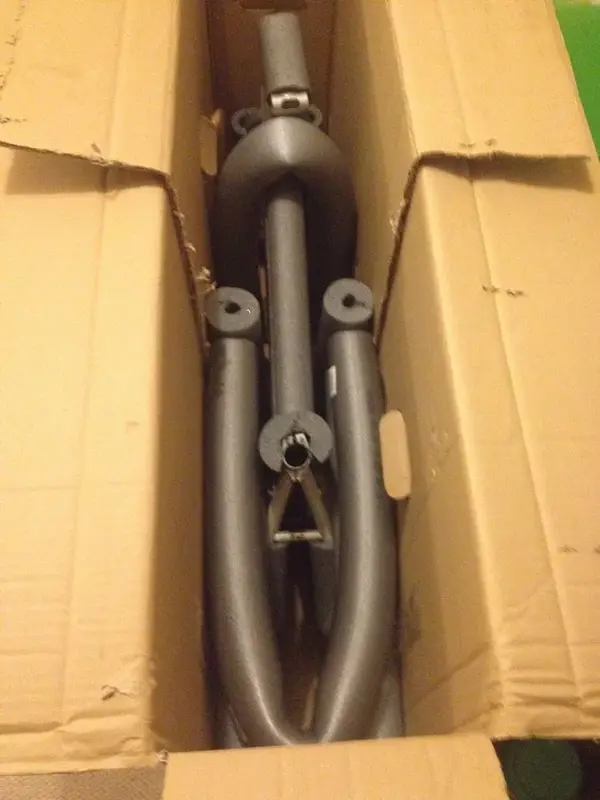

Recent frame I sent, bike box cut to size, and then pipe lagging - bits cut to length for each tube, and over the extremities. Then full lengths folded to fill the gaps. This meant that the frame couldn't move about in the box etc. Not the cheapest, but depends what the contents are worth...

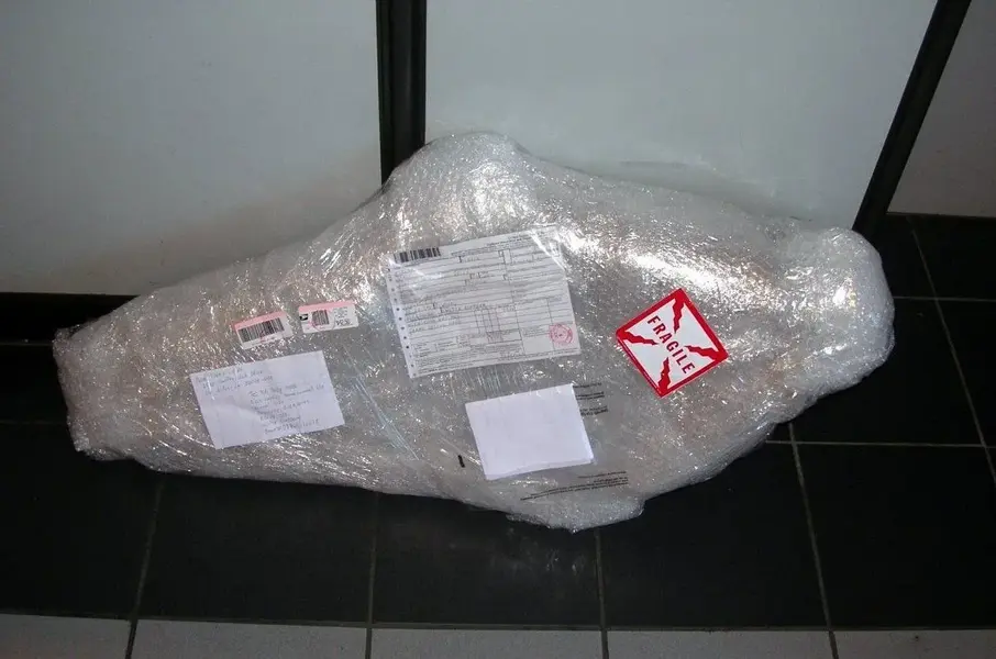

This is how my Kona King Kahuna frame was sent from California.
There were several layers of bubble wrap, with each layer tightly bound with layers of industrial strength cling film. It could have easily withstood a sever clout without any damage to the frame - must have taken the guy ages to wrap up though!
