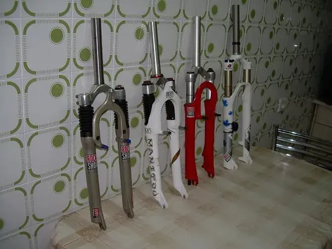

The sxr model is near the year 2000, so you should choose a frame from 1999 to 2002. But the most important is how tall is the fork, because I have a duke of 2002 that is similar than the Judy 1995, 2 or 3 cm more tall the duke, so you can fit some forks of the 2000 in old frames form 1995 for example
