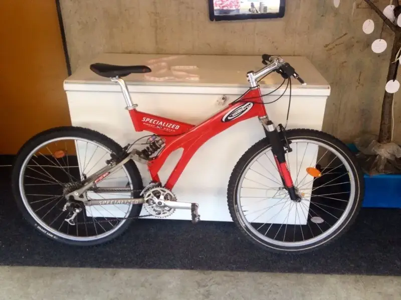

I just got my first full suspension today, a very old 1997 Specialized FSR Ground Control. For 217 pounds, cheap considering full suspensions in DK are rare!
It rides great, breaks great, feels like I'm floating! BUT it is a 19" frame, which is supposedly too big for me.
I'm a short guy 5'7-8 or around 170-72 cm. I should have a 17,5" frame. My previus mtb was a rigid 19" mtb, but I didn't notice any faults with the size.
On this bike though, I had to cut some of the stem off to reach the pedals when riding ;) And I do have to reach a tiny bit forward. But it is not at all unrideable, do still have loads of fun on it :P
So, I think it could be a bit smaller maybe. How could I downsize it?
The stem is semi long, about 120 mm. I could cut the seat down a lot further. But is this the right thing to do?

I'd go for a 90mm stem first.
If your seatpost has to drop any further than that just to comfortably reach the pedals, then I reckon it it definitely too big for you.
try turning the seatpost round
and as paul says shorter stem, riser bars will help too

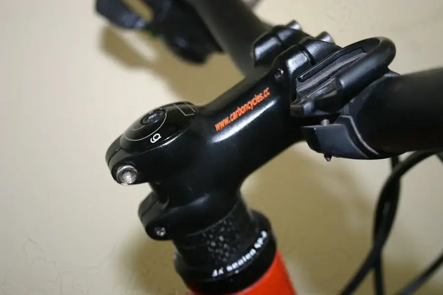

I had to adjust the fit on a 2004 Specialized Enduro for my son,similar sort of geometry as yours.I fitted a 60mm stem which sorted the reach problem perfectly.Got the stem off Ebay for £20,looked the same as a branded and much more expensive stem.

Can't agree with that.The boy has just bought his first brand new road bike and part of this was a proper professional bike fit session.Having first established the correct saddle height and saddle fore/aft adjustment,the last part of the process was to swop the standard 130mm stem for a 100mm stem.
Basically he is a teenager and his legs have grown faster than his arms,so he has the correct frame size for his height,but his arm length has yet to catch up.
I have fitted the same 60mm stem to my own Enduro,I prefer the more upright seating position and steering feel.Like my son I have long legs but relatively shorter arms so on the original stem I felt too stretched out.

I can reach the pedals just fine, no problem there, I can reach the pedal with my heel and leg stretched. :)
The reach is the main problem I think. But is there any like, wrongdoing in "adjusting" the bike in this way? I could sell it, and spend more money on a 17,5 frame...
