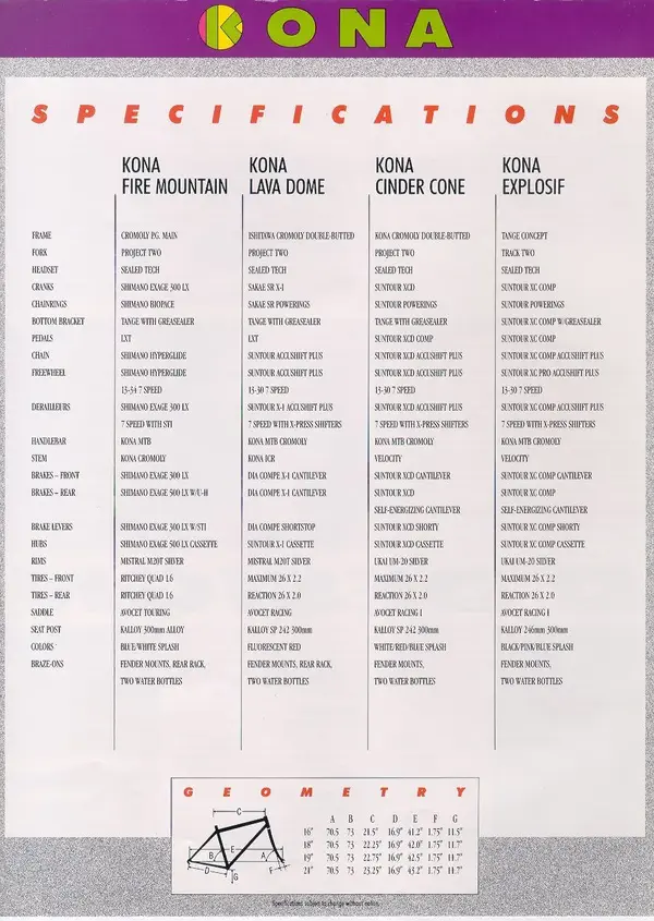

The F suggests the OEM manufacturer was "Fairly".
The tubing suggests Tange Prestige Concept.
The Bottom Bracket Grease Nipple suggests OE spec was Suntour.
The rear brake boss placement will help a lot in giving a definitive answer to the age. The rear cable route will also help determine the age, a plastic cable guide on the seat collar was introduced for the 91 model year, prior to this there was a steel cable noodle attached to the frame, prior to this it would have had a rear u brake mounted on the seatstays.
A picture will tell us all of the above i would hope.

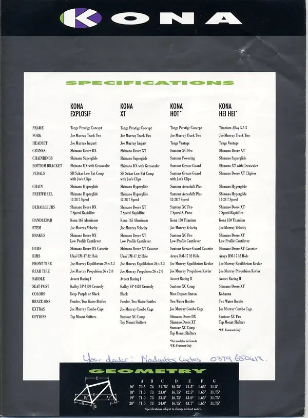

Without wanting to make things harder for you, i just noticed on the build spec sheets, that the Shimano specd bikes also came with grease nipples on the Bottom Brackets too... :facepalm:
The grease sealer bottom bracket nipple is a good point... all models had them, down to the Hahanna at the bottom of the pile.
It’s not a Hot though either. It would have a serial number beginning with TET to indicate Tom Teesdale as the builder. Thinking about it, my 91 Hot didn’t have the nipple thing from memory either....
Based on the spec and details my money would be on it being an Explosif pro. Some pictures will tell a thousand words though :)
