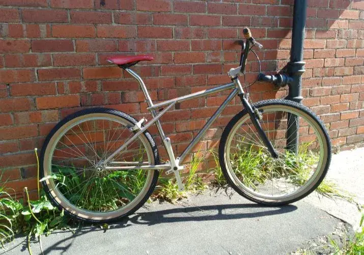

Any excuse to post a pic of my next project...😁
I'd say yes too small as standard set up...however done like this...all's good as a comfy crash about cruiser thing👍

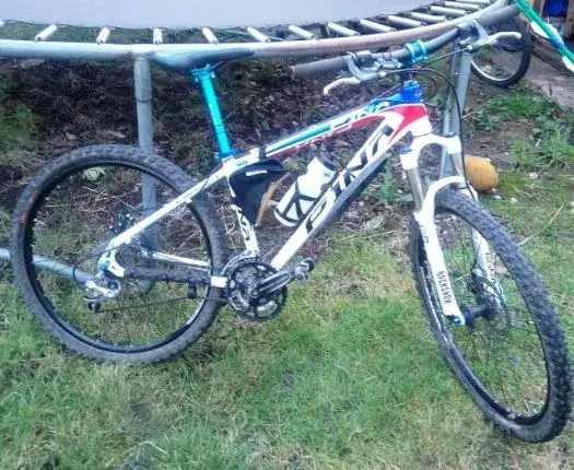

I'm around 5'8 and I had a 15" pinarello, I ended up having to use a 400m seat post to get it comfortable to ride for me, I've found the best frame sizes are 17-19 inch depending on style, so as Mickey said unless your going to do some modifications to it you'll be better with a slightly larger frame Screenshot_20220720-095002_Samsung Internet.webp
