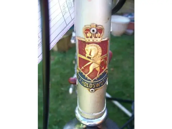

I'll stick my neck out pending some more images of the frame -
The Holdsworth typeface (on the downtube) is late sixties/seventies, cannot tell whether it has a metal headbadge (if it has one that puts it no later than seventies).

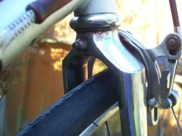

The fork crown looks sloping but is it lugged externally or internally (like a Cinelli) ? And a Campagnolo Victory or Triomphe chaninset is eighties; but then componentry rarely gives meaningful clues to age.

fork crown is sloping with no external lugs and tapers down nicely . silly as it sounds cant remember headbadge detail .

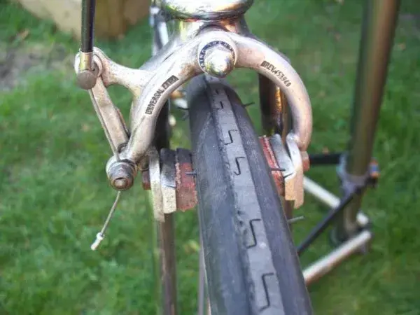

yes chainset is a lot later replacement might even replace it with a Super Moxy set not sure , fr & rr changer and levers are all period Campag . the brakes are just borderline on the amount of drop they have for 27" it came on 700 sprint and tubs with a few spare sprint wheels .

ok collected today from lbs who confirmed forks bear same number as frame so look original items , under side of Brooks Professional is stamped 66 so 1966 , brake calipers are Universal extra brev453949 type , and not enough drop to run 27" wheels so need to sort a nice pr of 700's .

fitted some 700c wheels along with some koolstop pads and off i went 2 miles later i can confirm rides nice and smooth , very impressed
