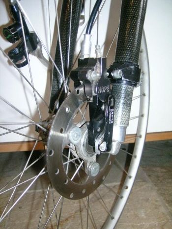

You can see the setup here:

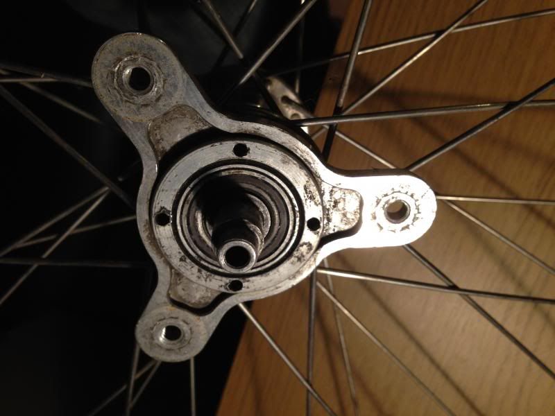

This is the hub.
This one is a bit different as it has no end cap on the axle at all because of the the width of the RC35 fork.
Does anyone know what specific hub was needed
Im trying to gather together the parts and ive most bits but not sure what is still missing
Hope C2 No1 caliper with Pace fork mount- CHECK however there appears to be 2 versions at least of this lower bolt on mount :?
Hub - CHECK Was hoping to use a nos bulb ive just got

Ive a number of axles but dont know which would be appropriate .Ive a feeling though that its a standard front axle for sus,sport etc but with the spacer removed. And ive a number of spacers of all types but dont know what it looks like :)

I dont think that Bulbs came with the same axle type as the Suspension (ti centred) front whic is what you would need to run the setup shown on the Pace fork above (I have one of these bough from Mr Panda years ago...
My bulb would work with an IS tab but I dont think it would work with any of the adaptors (unless you got a set up I havent seen before) The Bulb was about the time of International Standard.

I think you'll need a Suspension front....

Ive a nice silver pair of ti and fatso. I see fatso on the brochure but the spacers are radically different to the suspension so i dont know if that one is compatible :? Rest assured ive a few others :lol:
