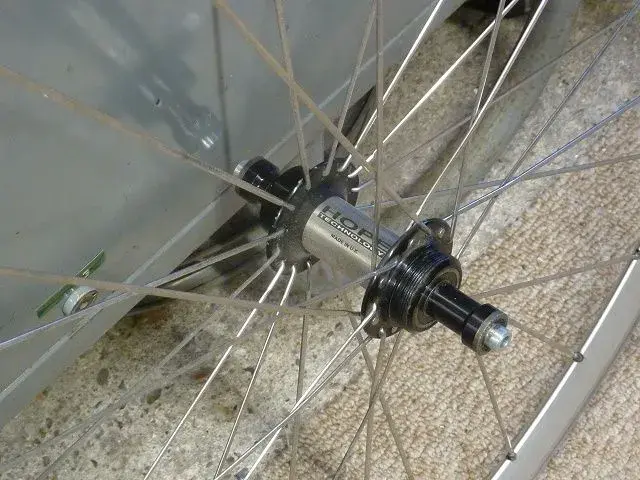

onegoodbike Merlin Fan Feedback View Aug 25, 2015 #1 Evening, Anyone know how to get one of these hubs apart?, there doesn't appear to be any flats to get a spanner on! . Any advice will be greatly appreciated. Cheers Matt Attachments hope hub.webp 55 KB · Views: 325
FluffyChicken Archivist Retrobike Rider Feedback View Aug 25, 2015 #2 Re: Hammer... http://www.retrobike.co.uk/gallery2/v/M ... p_029.html And check the pages either side too for text.
onegoodbike Merlin Fan Feedback View Aug 26, 2015 #3 Re: That's great, thanks. ......do the 'o' rings act as retainers for the spacers?, if they do how are they removed?.
FluffyChicken Archivist Retrobike Rider Feedback View Aug 26, 2015 #4 Re: The orings do (before that it was little grub screws) You just pull the spacer/endcaps off. (Might need to persuade them at the start) Often a tap on the axle will loosen them and you can tap the axle all the way off after that.
