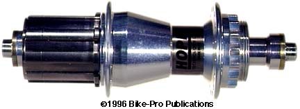

Sounds more like the disc versions of the Ti-Glide rear and Suspension or Fatso front hubs:
Hmm, nice! Mine are a bit different to that, they don't seem to be molded out of one piece, the spoke flanges seem to be pressed onto the middle silver bit.

Yep Ti glide with disc splined, that pretty much looks like mine.
