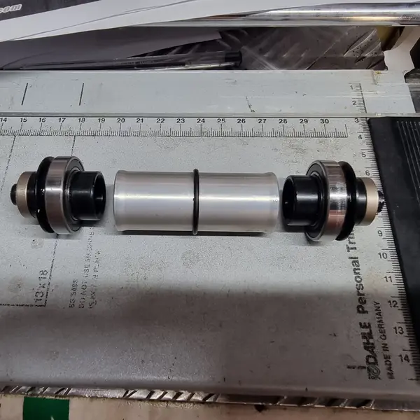

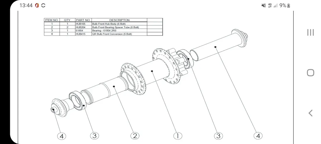

Can anyone ID this front hub please? Bulb is nearest I can find but exploded view doesn't match. Internals are more like a Fatsno. Same bearing & QR spacer each side. It's about 5mm too wide & I'd like to ID it check it's got the right internals. Think I bought it as part of a wheelset a few years ago (rather than coming off another bike).
Thanks. I've checked the bearings & they are correct. My disk side end cap differs completely & the other side too possibly on the outer side between the flange & metal collar. Is this the issue or just a different configuration?
Its actually 10mm too wide at 110mm.
Gone for a replacement Bulb hub as the internals outside of bearings look to be unobtainable so will keep this one for spares.

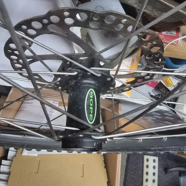

Been sold a right POS, Just gone to fit the rear & the rotor is about 5mm too far in-board! Investigation pending.
Post up pics. I have some Hope disc spacers in stock but 5mm is excessive. Look for an incorrect spindle adapter fitted. 🤷‍♂️
