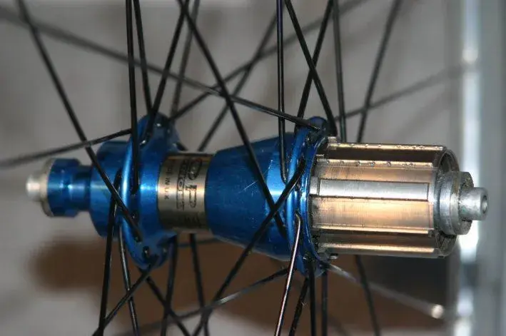

Finally took a pic of the rear - which I'm now confident is a Ti-Glide
I had a flange fail on a Ti-glide back in 1990's after six months use. I sent it back to hope and they replaced the offending flange with a replacement that had somewhat more meat in the flange between the drilling and OD of the flange.
I'd retire any hub with death cracks. Chewing tarmac costs a lot in dentist bills.
