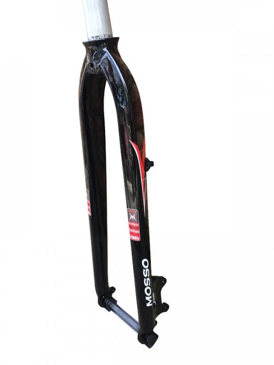

And I now want to fit these forks (or something similar for road only use):
Question is, which Hope adapter plate and/or caliper half do I need to fit the caliper?

If you're using those forks or something similar with an IS mount you need a no 3 or no 5 caliper and a spacer for your front hub to take up the space where the existing caliper was. I don't think the spacer was ever a standard part but it would take one of the members with a bit of steel or alu stock 5 mins to make one up.

no 5 caliper 165mm disc on front 145mm disc on rear
no 3 caliper 185mm disc on front 165mm disc on rear
the spacer is of a hope sport hub and think ive got one spare at home i can send u if u need one

Could you supply the parts I need to convert, assuming a 155 disc is compatible with some kind of caliper half? Not sure what's currently fitted - it's covered by an adapter plate.
Alternative is to fit a 165 disc, No.5 caliper and the spacer.

Spacer is a standard :wink: 13mm i think. Ill measure one and add it tonight.
And aye, a No 3 or 5 with the IS to IS mount.
