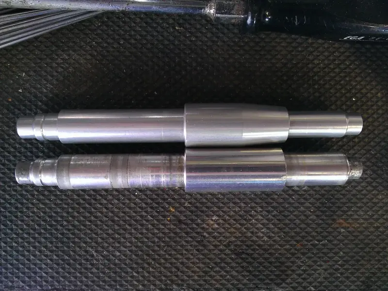

I have also attached a photo of both QR axles so you can see the difference

:shock: Ive just realised that is actually my pic :lol: i can see one of my personalized mini mono covers
I've since given away the short one for the bolt on No2(bottom axle), but ive still all of the rest in the pic.
Dyna-ti if you post some pictures of your of spacers i could probably tell you which ones or i will take a picture of mine when i am back over where my bike it.
Bigun none drive side should have a 15mm inside diameter.
The drive side should be the same as the XC and bulb spacer
