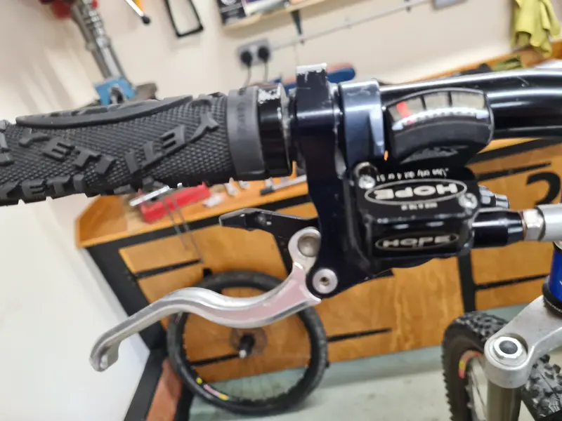

Does any body know if spares are available for hope 3 brakes still? Im not that familiar with them, but it looks like the kit on a bike I've ended up with needs possibly 2 master cylinders/ seals and possibly a piston kit. Also it needs pads.
Are they worth rebuilding (if the bits are available) or just replace the system wholesale?
Any ideas guys and girls

I had a recommendation on here for some on eBay, here’s the item number for more of the same…
126897408383
Mini - small brake caliper made from two halves bolted together.
Mono mini - small caliper made from one piece.
No3 - casting type of caliper / bracket to fit different mounts, before things were (kind of) standardised. Nowadays most calipers are the same you just by different brackets (lettered instead of numbered).
Be sure to pump the pistons part way out before you strip the caliper.
