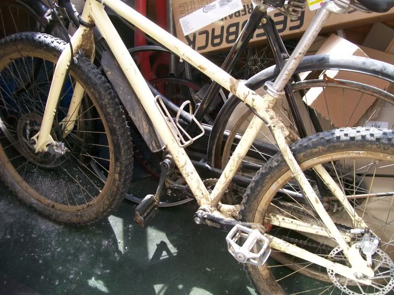

I did my trailstar with dulux gloss . People only really notice when I point it out , a liter only cost about £8 and I've only used a very small amount on both frame and forks . I didn't bother with primer and it's been fine for a year of neglect . I removed the original paint on the forks in the morning , painted a few coats during the day and was riding on them at the pines in the evening :lol:
If I get a scratch I just chip the mud off the area and slap some more on with a brush .
No point spending real money on nice paint for a bike I wont be cleaning

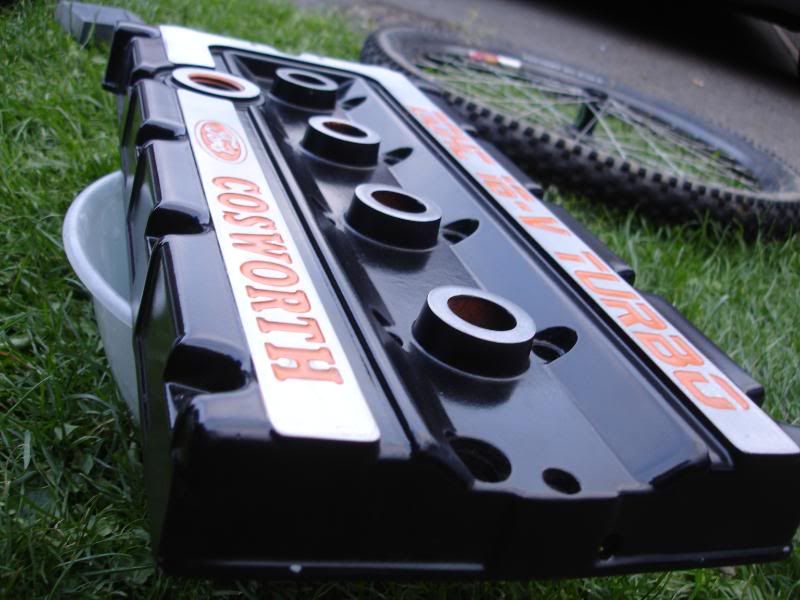

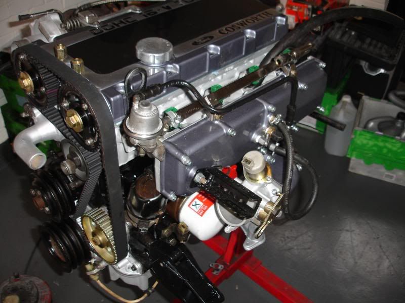

i beg to differ
all the items you see in the pics i painted with a rattle can in the garage,
all it takes is time,
n they have all proven them selfs the cam covers have been painted for well over a year n still look as fresh
Correct me if I am wrong, (despite being an Engineer by trade I will never confess to knowing much about engines!) But the painted surfaces on the samples you have shown are not likely to suffer much in the way of scratches or impacts?
It its when you get any sort of surface damage that the paint starts to fall off.
That said I am sure it is not always the case and it is possible to get a good durable finish...I just have not seen one on a bike.
Speaking from experience and a fellow engineer :D , the paint on a cam cover needs to be pretty tough too. The extremes in temperature, oil/water/other contaminants and plenty of high frequency vibrations all contribute to peeling paint. I've had a few mis-painted engines that only lasted a few months through trail and error :(
