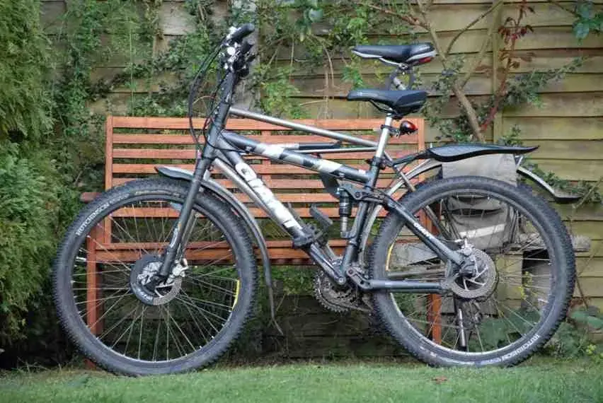

my loosely inspired marin

What make/model is it?

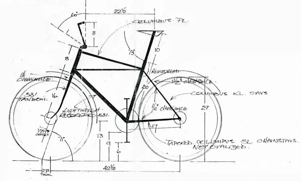

. From what you said at the beginning of the thread I can see that you understand that you can't get Cleland like handling and comfort from just sticking high handlebars on your normal mountain bike. In fact the handlebars do not need to be any higher than the saddle. But it is crucial that the top tube is short enough to take all your body weight off your arms when you sit bolt upright. Since standard size bikes come with top tubes that are too long the easy solution is to use a small frame with a long stem and seat post. The stem / bars should have no off-set for optimum handling and climbing ability.

The pictures below show the drawings for my 1988 650b Highpath and the same Highpath hidden behind a 2005 16.5" Giant NRS
