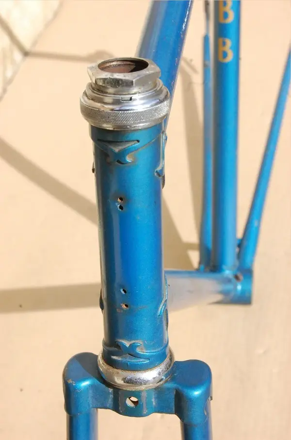

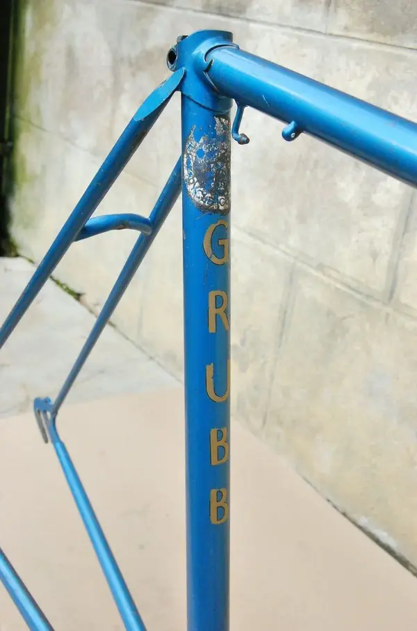

Would you say, then, that there is a possibility that this frame (which came with no headbadge and a single, misplaced decal) is not a Grubb? I saw the seam inside the seattube, and felt the one inside the downtube when the b.b. was off and I reached a finger inside.

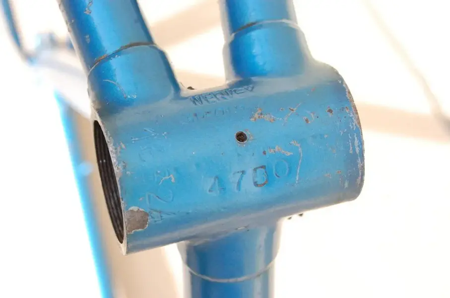

Two numbers on a Grubb? (I've seen Grubbs with a four-digit number, and some with a five-digit, but not both).

Could be a bit later model, musing cheaper tubing.. The ones I sold had a cast fork crown with a lamp bracket boss. The other fittings look like grubb. Obviously the head badge is a mystery.
Keith
Yes, this has the cast (rounded) fork crown and the lamp bracket boss, but it is not newer than 63 because Grubb discontinued the Nervex and went to Prugnat lugs in '64. Maybe what I was seeing is not a seam, but something other. Thanks for your replies. It helps me get a little closer.
