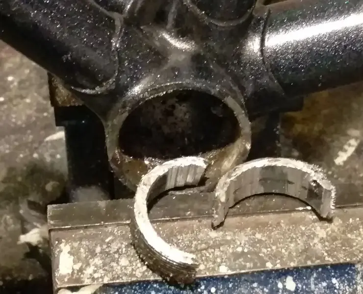

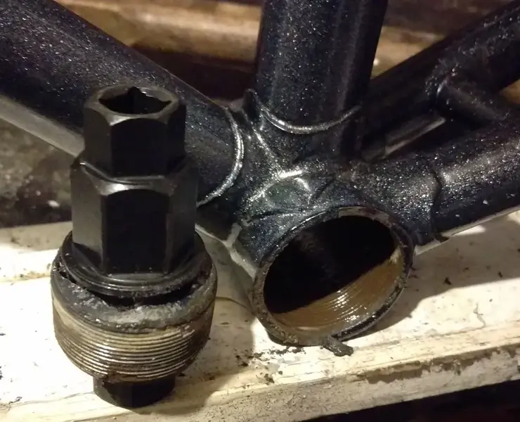

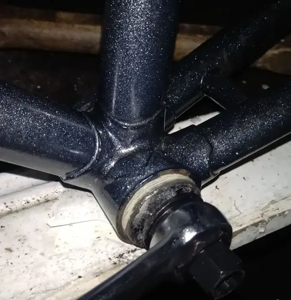

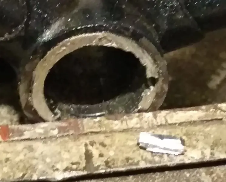

Finally got the BB lock rings out, LHS came out with a better Hex drive and mallet. Supported frame on BB shell. The RHS had to be cut in the end and broken up.
Seat stem still well stuck in, going to have to think of more options as causing too much damage to top of tube and lug.

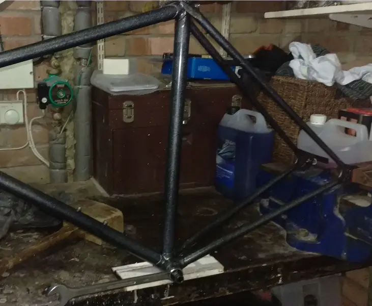

Seat stem still soaking, got some bits for temporary and full frame repair.

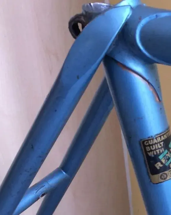

Btw that blue 'Special' pictured upthread seems to have a 'post '82' Reynolds decal (with the TI logo at the bottom) so the plot thickens regarding brake bridges- maybe they just sporadically ran out of the usual ones and used these instead?
