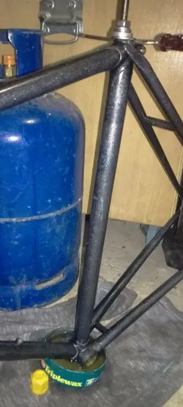

Re: Holdsworth Special - Frame Rescure
Give it a good soaking with Plus-Gas, a dose every day and keep it up for a week. It's amazing how that stuff loosens things. It works far better than WD40.
If you spray it into the seat tube from the BB (upside down of course!) it will help loosen from the bottom too.
Thanks, yes going to get that going and try at the w/e. If no luck will keep soaking it. Also seen some tricks for the remainder of BB cups. I think a bit of patience will pay off.

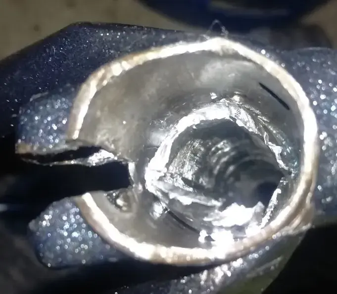

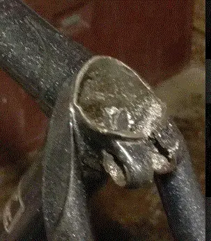

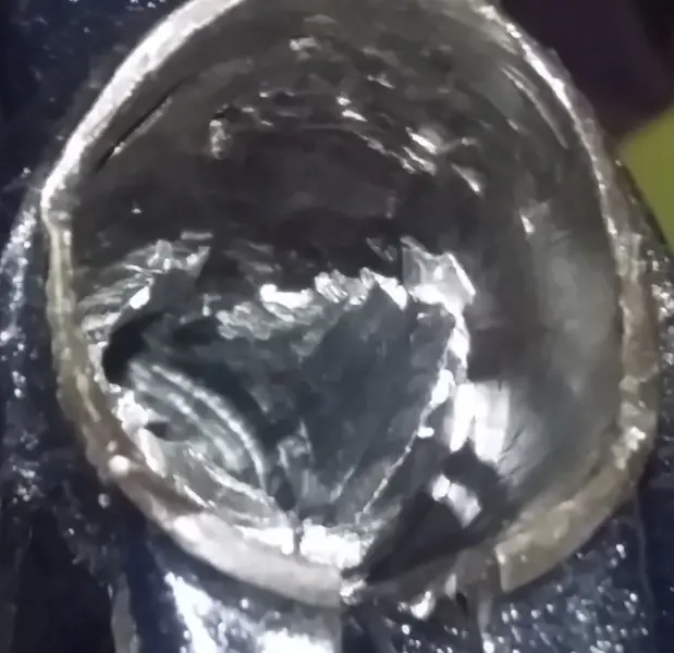

Next job, get the remains of the stem out. Having removed the tang to gain more access, this is what I am left with. Relatively clean now, just some burrs in the aluminium stem which I hope will not cause too much of a problem. I hope to draw it up the seat tube a bit to get it moving then see where to go from there. Currently soaking in preparation.

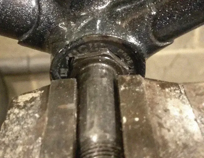

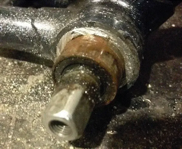

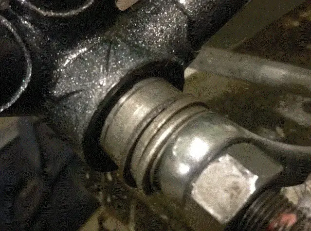

Not got the studding yet so had a go at the BB Cups. Tried a bolt and washer method seen on U tube and started by Sheldon Brown. As the is a cup each end I am a bit limited as to what I can use and can't turn it with a socket in the direction I want to. Clamped it up as tight as I could and ended up trashing the bolt, the thread was too fine perhaps.
Put a couple of cut in to it with hack saw, still didn't budge so filed a rough Hex into it and used the bolt as a wrench. With the bolt held int he vice I tried turning the frame until I thought I was going to do it some damage. Put frame on the floor and try to get a spanner on the head of the bolt, spanner slipped off as there is not enough of the head protruding.
Frame soaking on penetrating oil again, will try and get a 24mm hex wrench next week.

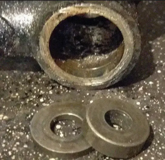

Used studding and washers to pull on the bottom of the seat stem. Difficult to get it sitting on the top of the seat tube and have installed bolt and washer to support the clamp side of the tube.
No movement yet, but not really put that much load on it. Left it soaking as best I can with load on it. As I cant soak everything at the same time will concentrate on BB first. Will nee to check the washers are not going to get pulled into the bottom of the stem then maybe fill the seat tube from the bottom with penetrating oil as this is now sealed off.
