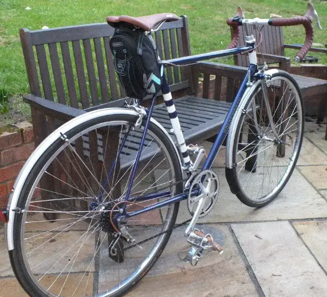

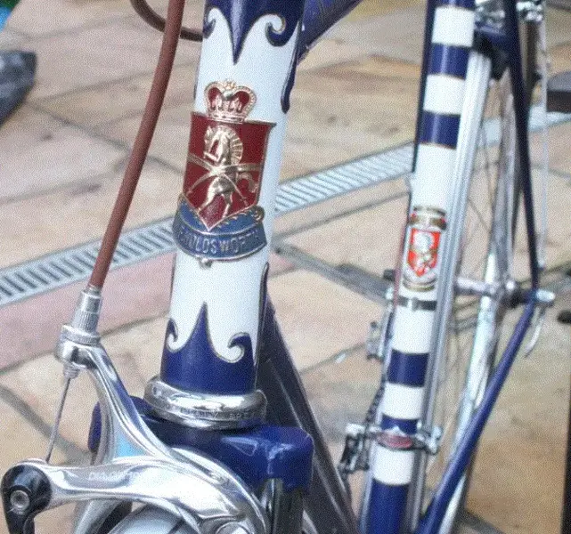

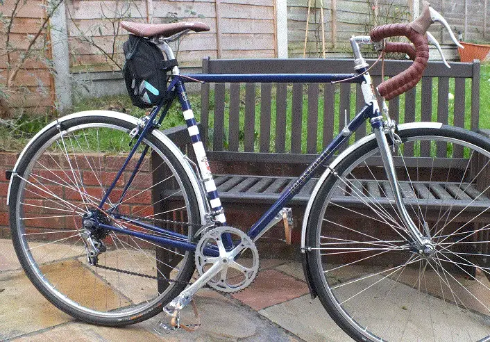

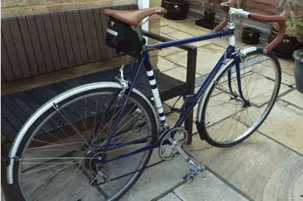

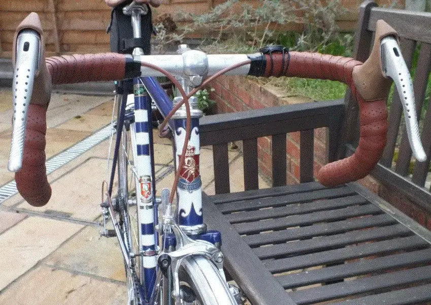

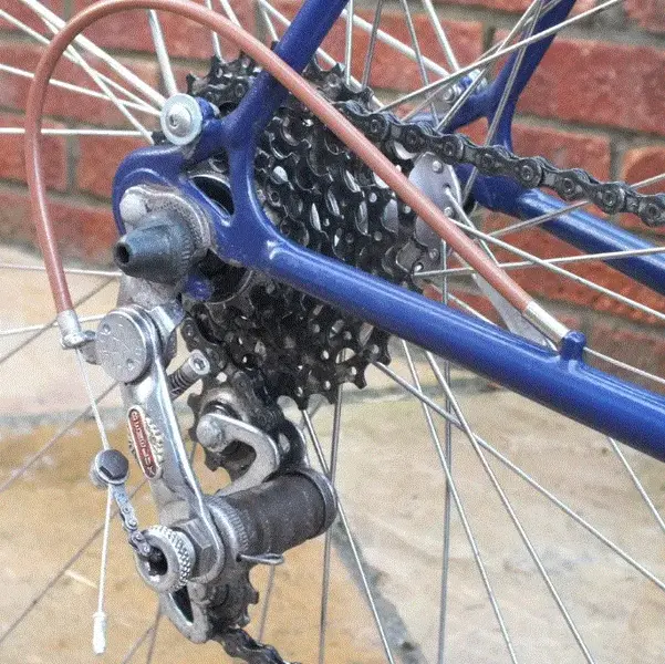

Finally finished the Monsoon, still not found the correct forks, but still looking. Far from original, but it fulfills two objectives, nostalgia and something to fiddle with. Replaced the original steel parts with aluminium and run 8sp on rear. Done about 100 miles on it so far most of it on club run last sat. went well.
Some pics below, more on Flikr

Looks very nice indeed! Who knew that a Benelux RD would run 8 speed? Not me for sure! Really like the mix of old & new components - gives the old girl new life!

Thanks, Yes you have to modify the RD a bit. In theory using a 10sp cassette you should cover 7sp's with a 5sp RD, but but is doesn't quite. So I modified the adjuster barrel screw and took it to 8sp. Could have wreaked it a bit and the wall thickness at the nose end of thread is only about 1mm, but it is steel. Also the thinner chain tends to fall off the lower plain jockey wheel and jam against the hanger with 8sp, that is fixed with at toothed lower wheel. Running an old pair of Shemano 105 hubs to get the frame spacing right then change the free hub to Hyper glide to run the 10sp gears.
Took a while to find duel pivot brakes of the right drop and drilled aero levers. Again Shemano do them, but you have to put up with name stickers all oevr them. These ones seem to do the job.
Changed the forks for somthing better, still not quite the rights ones, not 531, but more in keeping.
