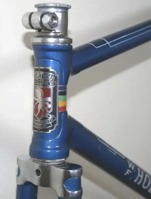

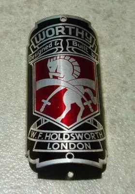

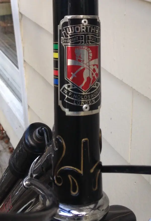

FYI. For comparison here's pics of Velobase aluminum badge, yours and my '51 Sirocco's reproduction badge obtained from HLlloyd's.
Doug

I also think it is not the original paintwork. Most probably it has been acquired BY this Peter who possibly has had it repainted at Holdsworth and a badge mounted on.
