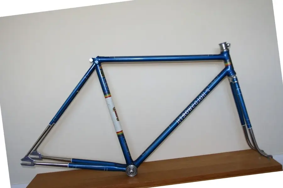

It all seems to match the frame description here.
Russ-style forks, fluted chain stays and rounded seat stays, Chater Lea fittings (at least the BB shell is clearly Chater Lea marked).
It also looks remarkably similar to the one in the catalogue.
I have however e-mailed the VCC's marquee enthusiast of Holdsworth and waiting to know more from him.

I agree looks more like early 30's. Fits 1934 catalog description of when Cyclone was a track frame only.
Dave Scrimshaw and myself spent some time trying to sort out serial number(s) on frame from eBay ad. On eBay pics there is the number 0520 on seat lug and 1563 on BB. We came to the most likely conclusion that 0520 represented the serial as this placement is as used on other similar vintage frames. This low number would also help place to c.1934. Also explanation of 1563, if not related to BB manufacture, could be that this is an early 60's renovation number. Head badge to me looks newer or perhaps a repro (I stand to be corrected) as believe at this early point badge was brass rather than aluminum which appeared later in 40's. If a number as well on steerer tube that may clarify.
I am no expert re these early vintage frames and will be very interesting to see where VCC expert dates.
Doug
