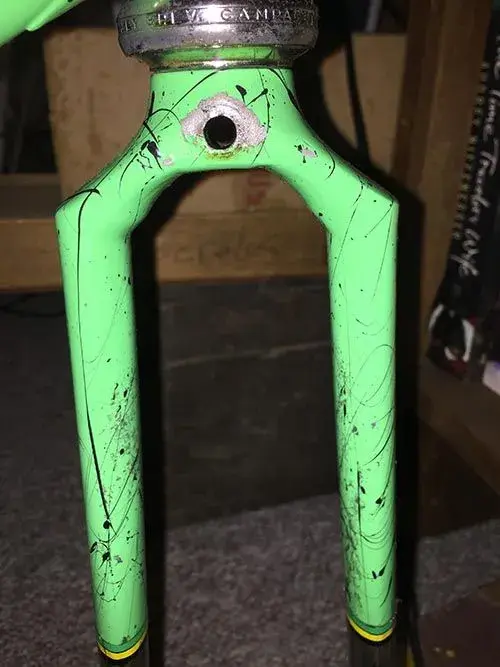

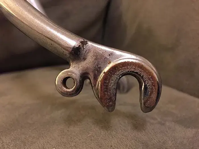

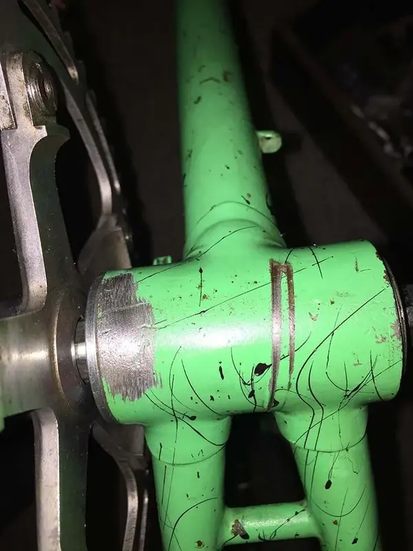

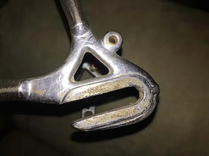

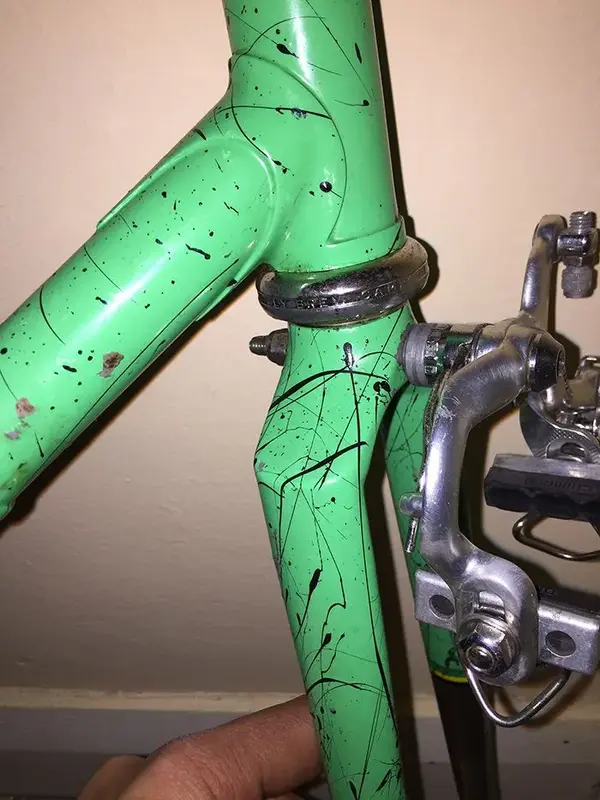

Holdsworth Reynolds 531 Frame??

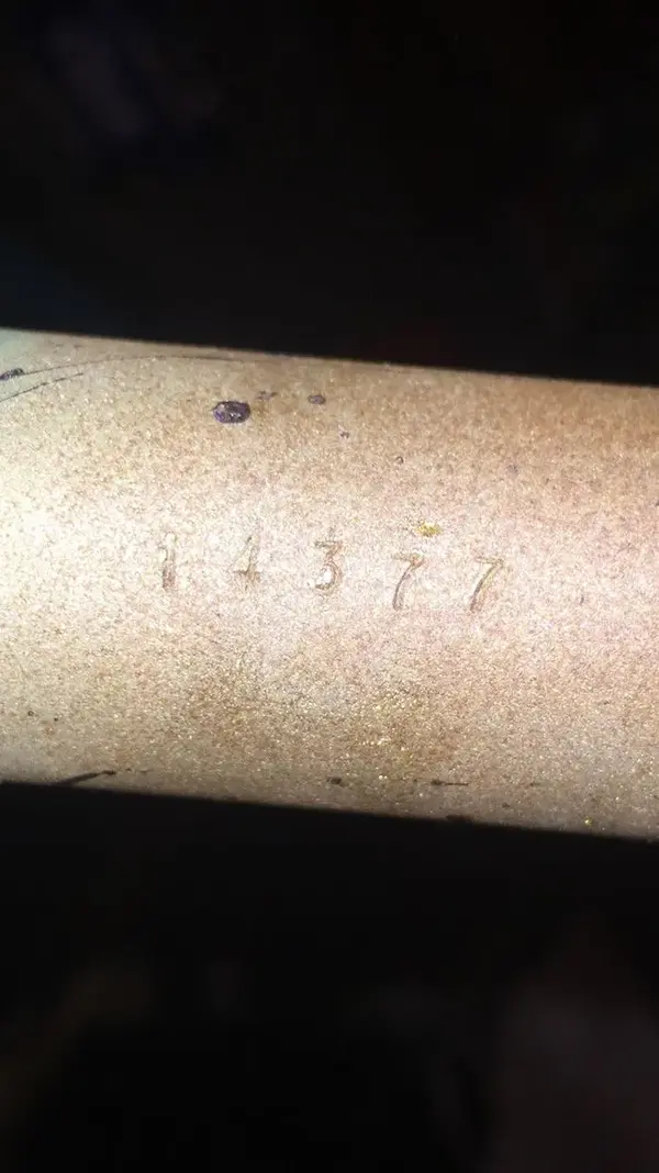

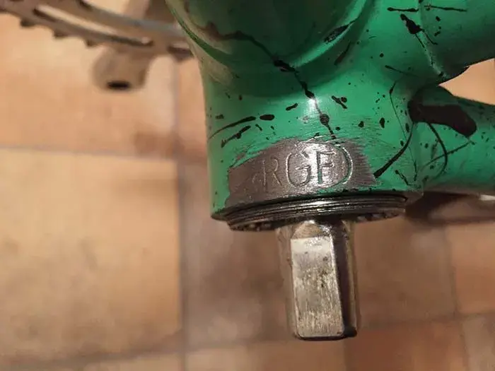

I recently acquired this bike frame and can't seem to find any info on it. I believe it may be a Holdsworth frame??
I wouldn't use parts as reference, I put them on during build.
Bike:
-Supposably Reynolds 531
-Campagnolo dropouts
-27mm seatpost
-Prugnat type s lugs
-RGF BB shell
-Fastback seat stay
-Forks '14377' only serial I could find
Any information would be great?
Cheers,
darker

Well, I could be wrong, but there's nothing about your frame that shouts 'Holdsworth' to me. Close-ups of the seat cluster, rear brake bridge, and any relief for the chain/sprockets at the inside bottom of the driveside seatstay/chainstay might ring a bell with someone.
With that fork-bend and geometry I'd guess this to be an 'Italia' styled frame from the early-mid sixties. Holdsworth did 'Italias', but so did a lot of other builders. The fact that you can find no serial number on the frame itself suggests three alternative possibilities:
1. For some reason it never had one.
2. The fork is not original to the frame.
3. The bottom bracket shell has been replaced at some point in time.
Some builders use(d) a numbering system where either the first two or last two digits indicate the year of build. Given the styling of the frame/fork it is highly unlikely that it dates from 1977, so I'm guessing that the serial number on the steerer is five digit sequential.
Re: Re:
I am glad you said that as I was of the same opinion about Holdsworth origins.
Just to clarify, I think this frame does have its original forks. No reason to think otherwise in this case. The work around the ends of the stays, and the ends of the fork blades, is distinctive, (i.e. it is not the usual 'dome',) and there doesn't appear to be a mismatch between the one and the other.

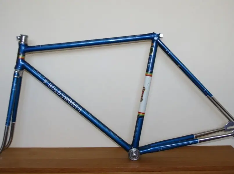

I have noticed this has been added to the spreadsheet. However I believe is more from 1934 than from 1939.
I have e-mailed VCC Hodsworth's marquee enthusiast to pick his brain on this.
I have, fyi, won that auction and I'll be hopefully receiving it soon.
