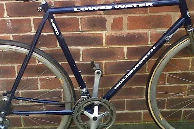

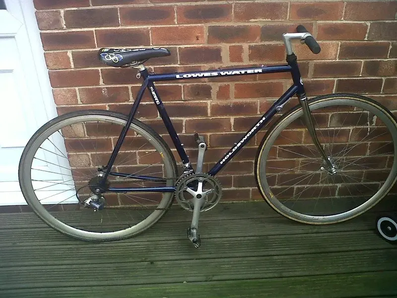

Attached photo of the frame, does it align to any particular model?
I’ll try and get some others from the owner
Thanks
Gus
Difficult to say from that picture, still thing this is post Malborogh take over. if that top tube is sloping down towards the seat tube and with the extend tube above the lug, that all looks more modern that the models in the Malborogh range. that crank set too looks very 80's/90's.
As DWS says, definitely post 'original' Holdsworth and also Marlboro's 1 year (very late 1985 - very early 1987) ownership of the brand.
So it's a "Holdsworth badged" Falcon and looks almost identical to the Claud Butler Professional (also made by Falcon) from 1994 although that used 7005 Aluminium not steel.
Do you know what material this is?
Could it be TIG welded Cr-mo steel? as that appeared around 1996 in the Claud range...

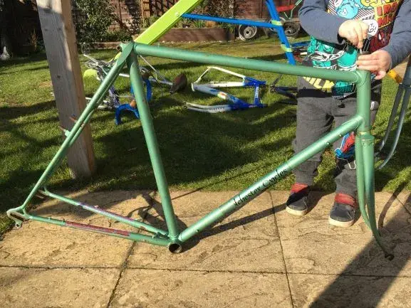

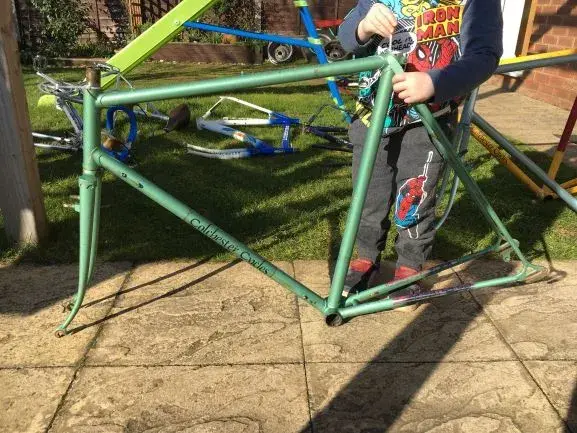

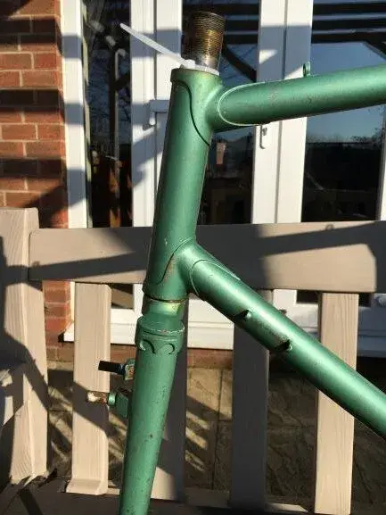

Hello All,
I've been reading this forum for a while and stumbled across it when trying to determine the origins of a couple of bikes in my collection.
I'm a bit of a newbie when it comes to the vintage stuff but have something that I'd like to find out a bit more about.
It was my late fathers and he purchased it new in about 1973 and rode it to some success in Cyclocross during that time.
I suspect it is a 1973 custom frame as the number is 3168 has all the braze on's for cross and is still wearing its original paint.
I have another in the collection to identify, which I'll post shortly.
Any help with this would be appreciated.
Kristian

Seems to be some logic to that assumption. The Competizion was listed with Cycle Cross option in that year and at first glance this could tie up. Lets see what other comments you get. I am interested to see the Colchester Cycles decals I see you are close to that area, might see out and about on it at some point.
I know Brian at Colchester Cycle Stores and dad used to race with him. He would of ordered through Brian, but he can’t recall.
I’m now looking at options as to what to do with it. Can’t decide whether to be true to its origins or do something to have the best of both worlds.
I have a couple of sets of Mafac cantilevers, brake levers, campy Nuevo Record derailleurs, bar end shifters plus GB bars and stems. But I could mix some 10 speed campag to make it more modern.
